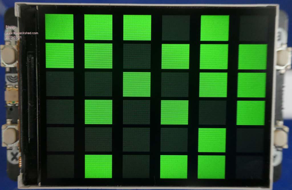

Continuing on the clock theme, here is a simple binary clock, using the Pimoroni 320x240 Pico display, it reads from top to bottom, Seconds, Minutes, Hours, Day(of month), Month, Year(minus 2000). So the picture reads 11:55:58 21/02/22
If you don't like the ordering it is simple to change, just change what goes in each of the elements of array digit() you will need to then check that the appropriate elements are being checked by the code for screen updates.
Screen brightness is controlled by pressing the edge buttons, up is 'Y' or 'B', Down is 'X' or 'A'.

Funny clock.
I have seen dual binary clock, but this I have never seen before.
My mind can translate from 4 bits to numbers, but this requires real dee thinking.
And since all is green, I got lost a bit.
But it is a funny project.
