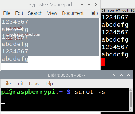

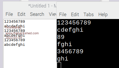

I can copy a session of MMBasic/minicom and then paste to MousePad
Works fine ....
BUT ....
If I copy from MousePad and then try to paste to MMBasic/minicom
I loose and confuse the left side ( see pic ):
my site
Posted: 08:56pm 18 Feb 2022
  hitsware2 said  [...]I copy from MousePad and then try to paste to MMBasic/minicom
I loose and confuse the left side [...]
you are trying to paste into MMbasic's onboard editor, yes? to do this successfully you need to be using a terminal emulator that is 'MMbasic aware'. minicom is not such a terminal emulator.

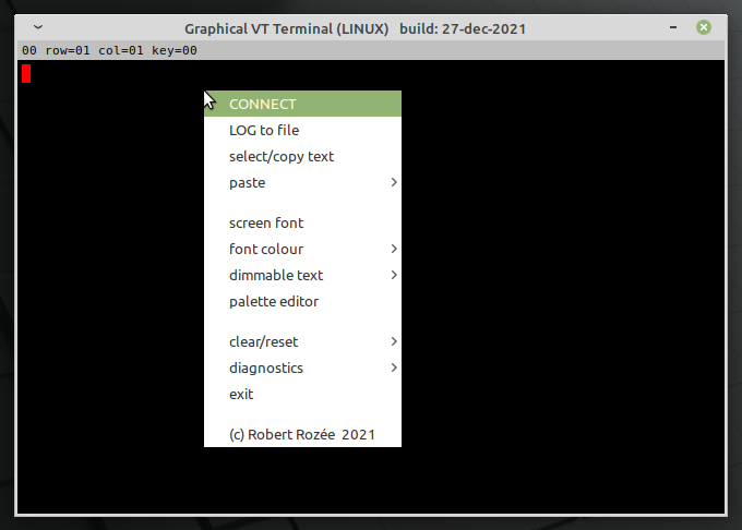

Posted: 03:13am 20 Feb 2022
hmmm, i do need to have it display some something more intuitive, like instructions, on startup!
right-click within the terminal window to bring up the menu. this is the main command interface. select 'CONNECT' from the menu, and go from there.
you can, alternatively, press ctrl-space to resume the last successful connection.
rob   :-)

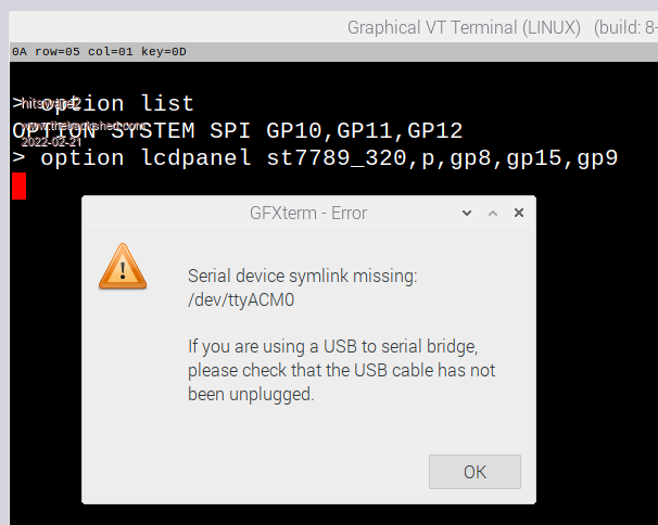

When I load options it drops the connection....???
MiniCom gives a short message, but then reconnects ....
my site
Posted: 01:46am 21 Feb 2022
  hitsware2 said  BUT
that is because the pico drops the USB connection when certain option settings are changed. MMbasic on the pico then restarts itself from scratch and establishes a new USB link, often (but not always) under the same /dev/tty name as previously.
you can try reconnecting (using the same /dev/tty name) by (1) hitting ENTER to close the error window and then (2) pressing ctrl-space. this may well work provided it was a 'clean' USB unplug event. on some systems the pico does not cleanly drop the USB connection, which results in either a new /dev/tty/ name being assigned, or linux's USB subsystem crashing.

hitsware2
Joined: 03/08/2019
Posts: 738
Posted: 02:11am 21 Feb 2022
For some reason ....
With MiniCom ....
No matter what the option is ....
When I hit enter ( the option )
There is a quick flash of the
same message I get if I ( from the terminal )
type in minicom , enter .....
But have no connection
( USB unplugged or switch off )
But it lasts only few moments
then reconnects ?????
Nice feature actually ........
