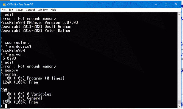

Cannot enter the editor - says there is not enough memory, when there appears to be plenty:

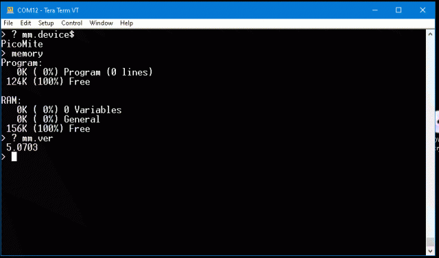

EDIT: Latest final version of the NON-VGA firmware, the editor works fine.

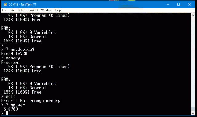

  Quote  Cannot enter the editor - says there is not enough memory, when there appears to be plenty:
The issue is that you swapped firmware from PicoMite to PicoMiteVGA. If you do this you MUST use OPTION RESET to reset the RAM amount.
Note in your screenshot it says 124KB program space i.e. PicoMite but the banner says PicoMiteVGA
I'll make the firmware force this in the next beta
