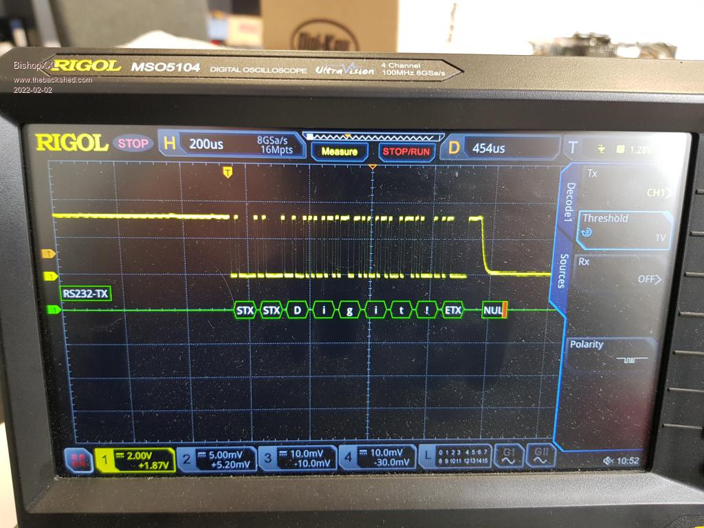

My wish is to output a text on the serial interface.
Later I would like to realize a fast communication with the PC at the USB port.
I noticed that something is wrong at the end of the bitstream.
It looks like 2 bytes are always missing and an error occurs because the last character is recognized as NULL.
The delay at the end I get away with a pull down I've tried.

yes that is odd. the Tx line is normally/should be left in a "marking" state; that slow tail off will leave the Tx line in a bad state for the next line. I don't know whether that is the effect of closing the channel (try again without the Close#1) but it doesn't sound right. It makes sense that if the pin is defined as a serial Tx it should adhere to the standards until re-assigned regardless of whether the channel is open or closed.
Also; try putting DO:LOOP at the end of your prog just in case it is something to do with the interpretter returning to immediate mode.
I suspect the NUL is just your analyser doing its best to make sense of the incorrect state and not a "real" character - the very slow fall doesn't match the rest of the data edges

Closing the serial port will put it into undefined or high Z state.
Use a pullup to hold it high and you have to redefine the pins before trying to use the port again.

This was discussed before, I proposed to release the IO pins with a new Setpin command, but keep them connected to the UART at "Close".
Peters comment was that that was not his intention. His response was that you need to have a pullup to "idle" state anyway, otherwise the lines are not defined BEFORE you open the UART. So if you add a pullup, the system is well defined before AND after UART communication.
In your case the IO lines are immediately released (the "close") before the UART has transmitted all buffered content. Since you have no idea how much is in the UART buffer, it may be hard to do anything to guarantee all is sent.
Maybe it is better to check if all is sent before closing the COM

Could the missing characters at the end be the result of the port closing before the transmit buffer is empty? A short pause before closing should fix that, along with the pullup previously mentioned.
PAUSE 0.2 'mS should be enough to send 2 bytes at 115200 baud.

Hello, that was the right hint,
I used a pullup and the lof()
and it works.
THX everyone

I had the same problem earlier. It was necessary to wait until LOF was 256 and then add a pause a bit longer than the transmit time of the last character. Geoff fixed it so that MMBasic will wait until the last character has been sent before closing the port.
I don't know if this has carried through to the Pico.
From the Micromite change log:
  Quote  When a serial port is closed MMBasic will now wait for any data in the transmit buffer to be
sent before shutting off the port. Previously the port would have been closed immediately
and any characters in the buffer would have been discarded
