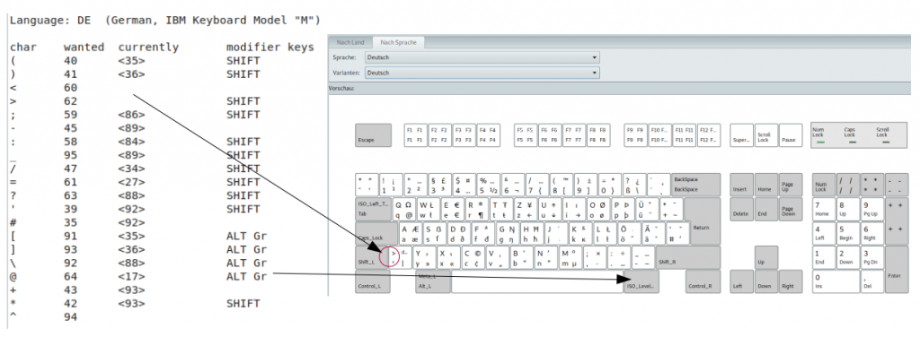

Hello Peter,
for the german keyboard, I found these keys (may be not complete, but the most importand)
-andreas

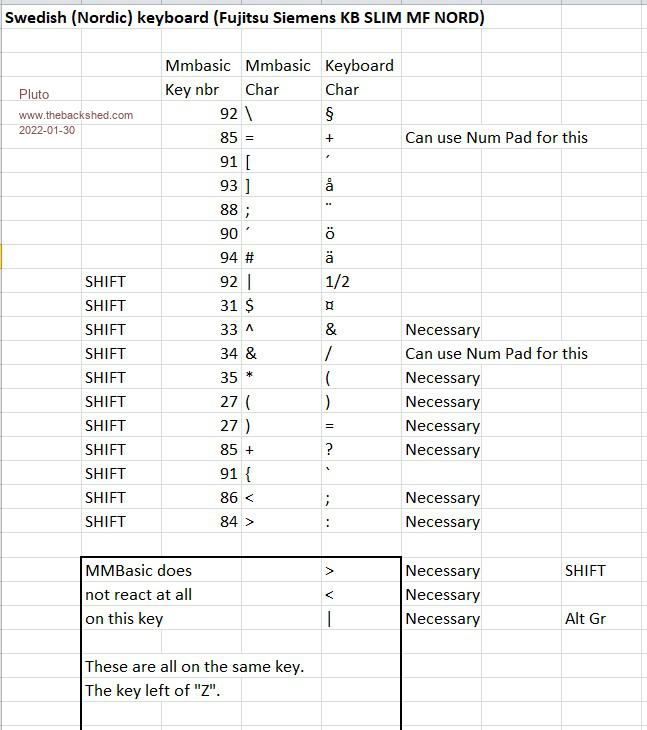

Pluto
Joined: 09/06/2017
Location: Finland
Posts: 421
Posted: 07:47pm 29 Jan 2022
These are the keys that need some fixing.
As you can see there are several differences between what MMBasic displays and what is shown on the keyboard keys. I do not think that all need to be "translated". Indicated the necessary ones in the table.
The "<, >, |" key has no action at all in MMBasic.
Hopefully you can interpret my table. If not please advice me how to present.
/Fred

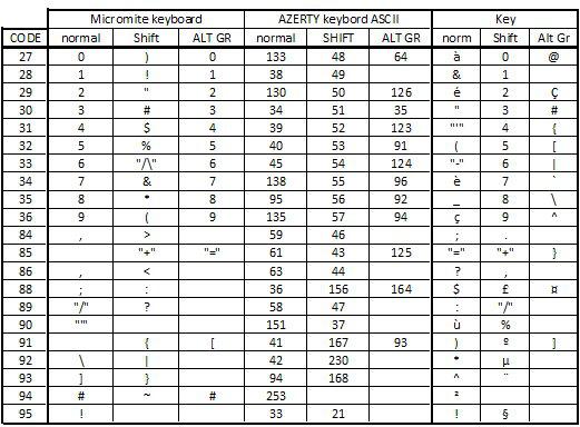

goc30
Joined: 12/04/2017
Posts: 435
Posted: 02:26am 30 Jan 2022
my config : French keyboard AZERTY
keyboard.zip
Edited 2022-01-30 12:31 by goc30
