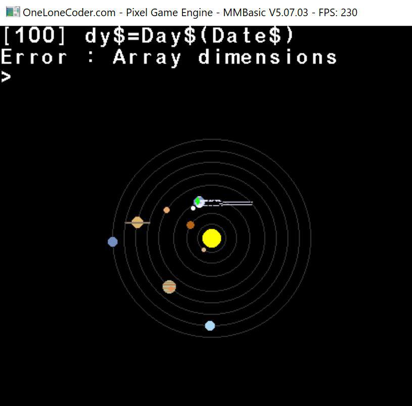

I did try the solarsys.bas file but it;s written for a display so all I could do was list it to prove load, list and run works
Edit: after modifing the program I managed to get it as far as here
I'm sure people with real knowledge of MMBASIC can get it running perfectly
Edited 2022-01-26 03:29 by lew247

  Quote  I'm sure people with real knowledge of MMBASIC can get it running perfectly
day$() and date$ not implemented yet so not your fault

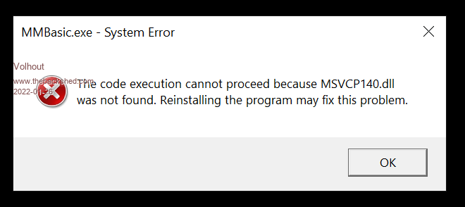

Hi Peter,
Not being a windows guy, I will see if I can solve it.
EDIT: from a Youtube video, I installed C++ 2015 and that solved it.
MMBasic is quite power hungry. Just am empty screen, not even in edit mode.
Edited 2022-01-26 05:20 by Volhout
Posts: 12185
Posted: 06:52pm 25 Jan 2022
  Quote  Not being a windows guy, I will see if I can solve it.
Would normally be there if anything C++ has ever been used. Install from link should fix it
https://www.microsoft.com/en-us/download/details.aspx?id=53840

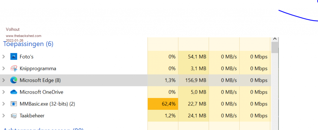

Posted: 07:26pm 25 Jan 2022
@Peter,
Is there any way to bring back the CPU load ? My laptop fan is screaming, and the CPU is 60%....90% busy while MMBasic is idle (edit screen, doing nothing) (4 core i5).
Edited 2022-01-26 05:27 by Volhout
Posts: 12185
Posted: 07:28pm 25 Jan 2022
  Quote  Is there any way to bring back the CPU load ?
Yes but that's for a later day - it's a pre-salpha. At the moment three threads are running each in a tight loop + a 4th thread executing every millisecond
