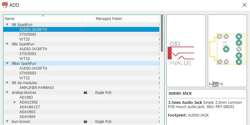

Sparkfun has this Eaglecad part for a largish 3.5mm audio socket:
I have used a footprint with 5 or 6 pins organized as dual-in-line, but I can't find it now.

The sparkfun one might be a bit too big, getting tight on space.

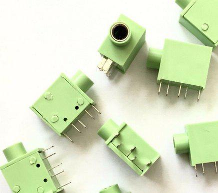

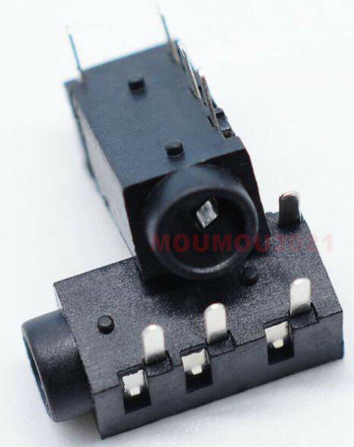

3.5mm 4-pin:
3.5mm 5-pin:

I've used parts like that top photo, but haven't found an eagle part, and have bent and filed pins to get them to fit in evenly spaced holes.
