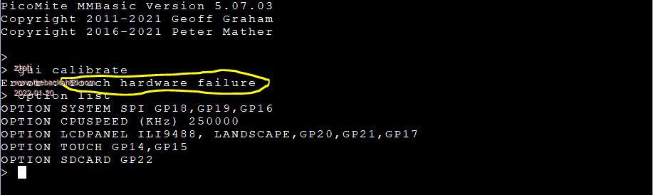

Hello,
I've tried to configure ILI9488 display with my previous ILI9341 setup ( ILI9341 works great), but after GUI CALIBRATE, I touched first two targets with no problem and suddenly calibrate procedure stop with a message "Touch hardware failure".
Any solution for this problem?
GUI TEST LCDPANEL works.
Thank you.

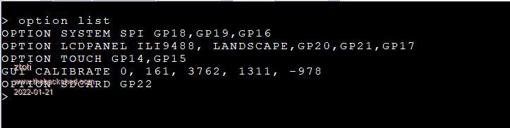

Lizby,
It works with 680ohm resistor, thank you.
Also I tried without the resistor, with your calibration values - doesn't work.
Thank you again.
Posts: 3881
Posted: 01:37pm 20 Jan 2022
Glad it works, and yay for the 680R resistor. What GUI CALIBRATE values did you get (shown with OPTION LIST)?
