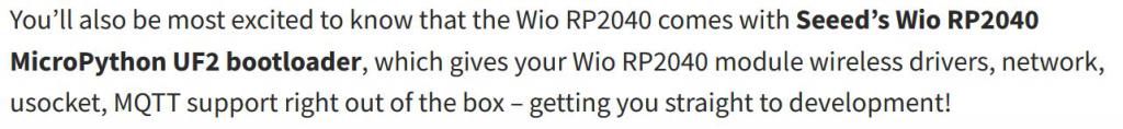

THIS is the SeedStudio MicroPython UF2 file
It has support with wireless drivers, network, usocket, MQTT, supported out of the box

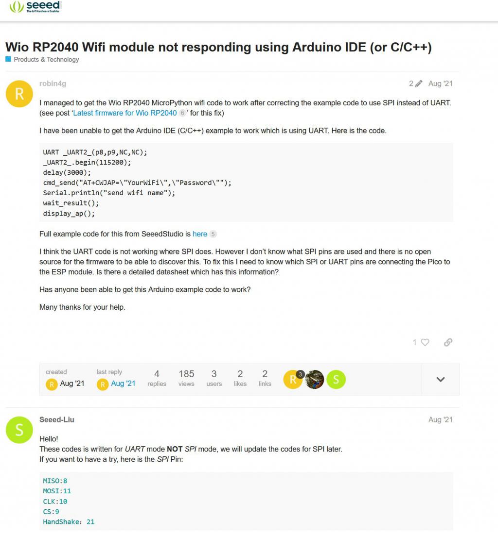

I did wonder because this is what their documentation says

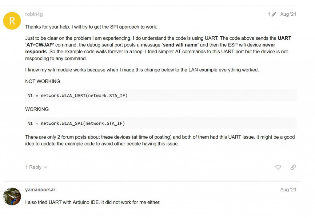

I've asked SeedStudio direct how to communicate with the ESP8285 ie which uart GPIO it uses
In the Meantime I know it can communicate via SPI I've got that working
Can anyone tell me if this is correct?
SETPIN GPIO11, GPIO8, GPIO12, SPI2  'Miso GPIO8, MOSI GPIO11, CLK GPIO10
Then if that is correct can anyone tell me how to send and receive the AT commands?

Posted: 01:33pm 18 Jan 2022
I would try each of:
1(i) use Arduino to make stuff work (looks like via SPI)
(ii) tweak code to MMBasic syntax
2(i) get 8285 into UART mode
(ii) use Peter's code for 8266
Both should work, with time & effort.
It strikes me that if there are poor or no Arduino examples the maker will hardly sell devices!
Plus, it will be very hard to use MMBasic.
