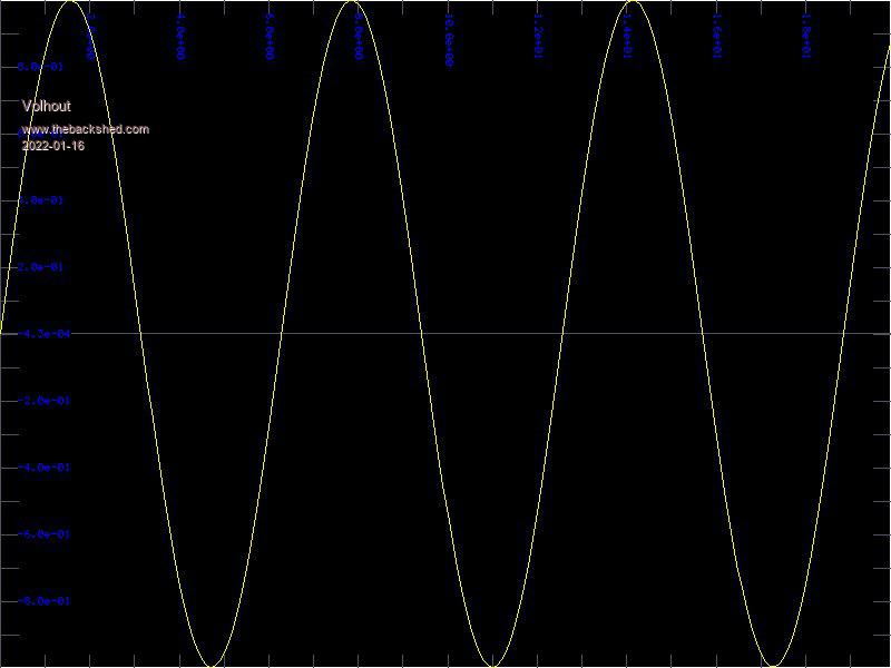

As suggested by Tom, I started to write a universal plot routine for data in arrays.
This is the first level, it plots X/Y data from array. I plan to expand it to support multiple lines.
The plot.inc file contains a function that you can call from the main, with an array as variable. When no other variables are given the plot routine examines the array to determine the size of the array, ranges to data and plots full screen.
Additional parameters can be handed to the function, such as the part of the array that must be plotted, and where on screen the plot must be placed, and what size.
The code: plot.inc

This is what it looks like at the moment...

I did not know line could draw coordinates from an array. I'll try if i can make use of it.
I had to split the 2d array into two linear arrays to allow for different gain and offset to map to the plot window. But maybe that can be done smarter.
