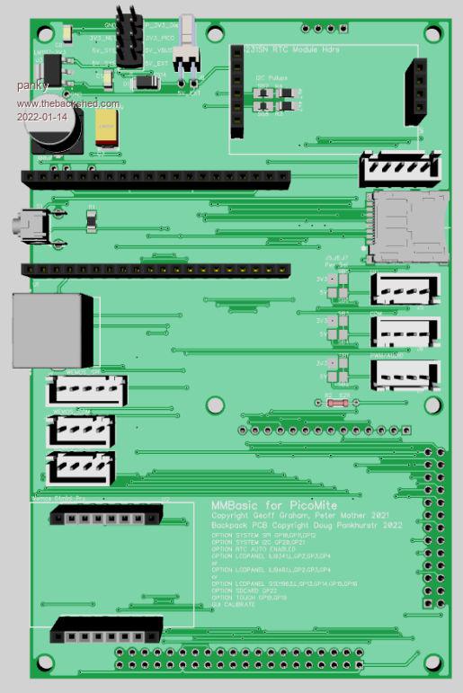

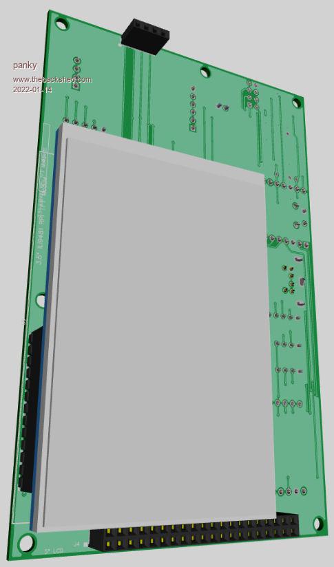

Like Mick, I decided to try my hand at a PCB for the PicoMite to support the new release that has support for SSD1963 displays.
My take uses the 5" LCD formfactor, but also has connectors for the 2.8" ILI9341 and 3.5" (RPi pinout) ILI9481 based LCDs.
I also include a WEMOS D1 mini pro as an expansion option running Annex RDS to provide an extra I2C or SPI or just a few GPIO options.
All I/O connectors shown are JST but could be any 0.1" spacing connectors.
Power supply configurations allow for external 5V to a 3V3 reg to provide all power to the Pico.

3.5" RPi form ILI9481 LCD mounted
2.8" ILI9341 LCD mounted

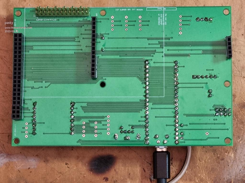

Board only without any modules installed
Board with all modules installed
5" SSD1963 LCD mounted

Looks nice. What PCB software are you using?
Do you have traces running under the Wemos antenna area? The render looks like a D1 Pro rather than the non-Pro board.
Even though the female PCB socket and male header pins (assuming it is not soldered directly to the board) will raise it off the PCB I wonder about the effect of antenna radiating into signal traces.
If D1 Pro you could use an external antenna, but regular D1 mini uses a PCB trace antenna, not sure if main board traces can affect Wifi signal etc

I am using DipTrace as the PCB software and I pull 3D CAD module objects in FreeCAD then export them out as .step so I can add them to my pattern library. They are just for show really but help to envisage what the final project will look like.
You are correct re the traces under the D1 mini but the ones I have a pro and I intend to use an external antenna (in fact, the pro's I ordered came with the antenna and cable).
I might try to re-route the traces just in case.

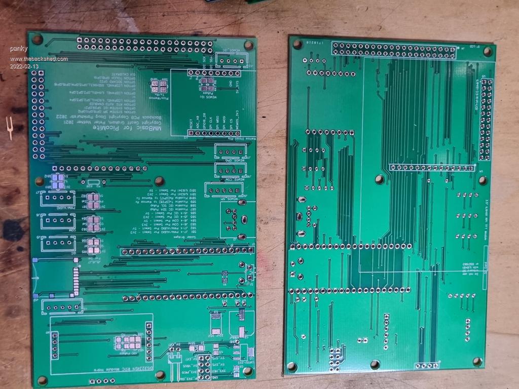

Posted: 02:16am 13 Feb 2022

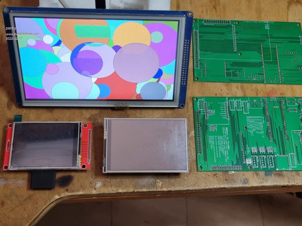

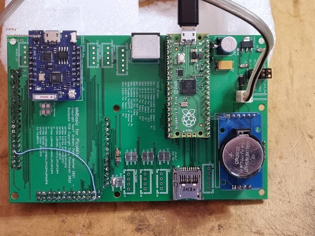

With the advent of SSD1963 support, I decided to update the backpack to cater for 2.8", 3.5" and 5/7" LCDs. I also upgraded to a Wemos D1 mini Pro as the 8266 interface.
Boards arrived a couple of days ago and have spent the last 2 days building. Only one board error (you can see the jumper below) - I missed LCD_CS to the ILI displays.
All 3 LCDs tested on this PCB and all work fine.
The 2 other ILI supported LCDs in front.
No interface connectors installed yet. The blue jumper is the one error on the PCB. There are a number of errors in the text for options however.
The board caters for 3 different LCDs - an SSD1963 form connector that will handle 4.3", 5" (the PCB size for mounting), 7" (tested OK) and 9", together with connectors for ILI9341 2.8" and ILI9481 3.5" (RasPi form).

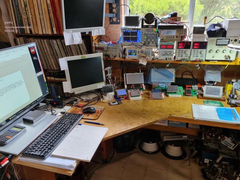

The workspace - at 73, no idea how much longer my eyes will hold out and even less idea what will become of it all after that - hopefully I can find a grandchild or niece/nephew to bequeath/burden with it all

Posted: 06:09am 13 Feb 2022
Man, you could land a jumbo jet with that lot
Totaly envious of the neatness

Since Son II moved back here with us I can hardly get into my shed. It turned back into a dumping ground and there was only a little bit of bench space to start with. I'm currently working on a tiny patch of table top with a few piles of small boxes in the vicinity. It's certainly not ideal. :(

The desk space is indeed enviable, but I have to wonder if some effort was put into making it look that way for the sake of the photo.
And, more on-topic, the board is nifty. I've always said that my workspace is the battleground between chaos and order. It always looks like chaos is winning, but order comes out of it in the form of working programs (and sometimes, since I retired, working electronic devices.)
