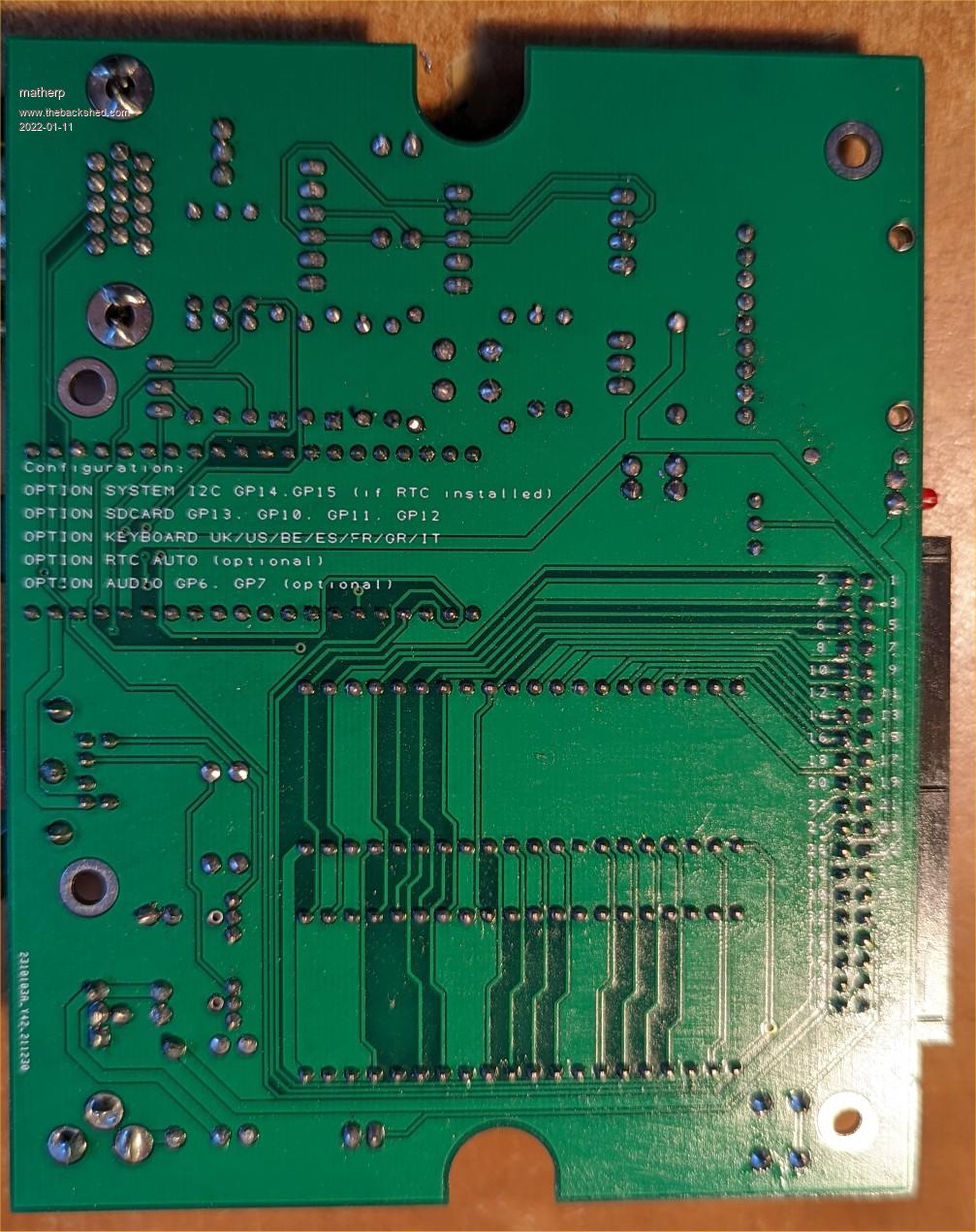

No faults
PicoMiteVGA.zip
ZIP contains a ZIP with the gerbers ready to send to JLC
Bill of materials, DesignSpark design files and printable schematic
NB: lots of bits on the PCB are optional depending on use - see BOM for details

PicoMiteVGA.zip
Edited 2022-01-15 21:27 by matherp

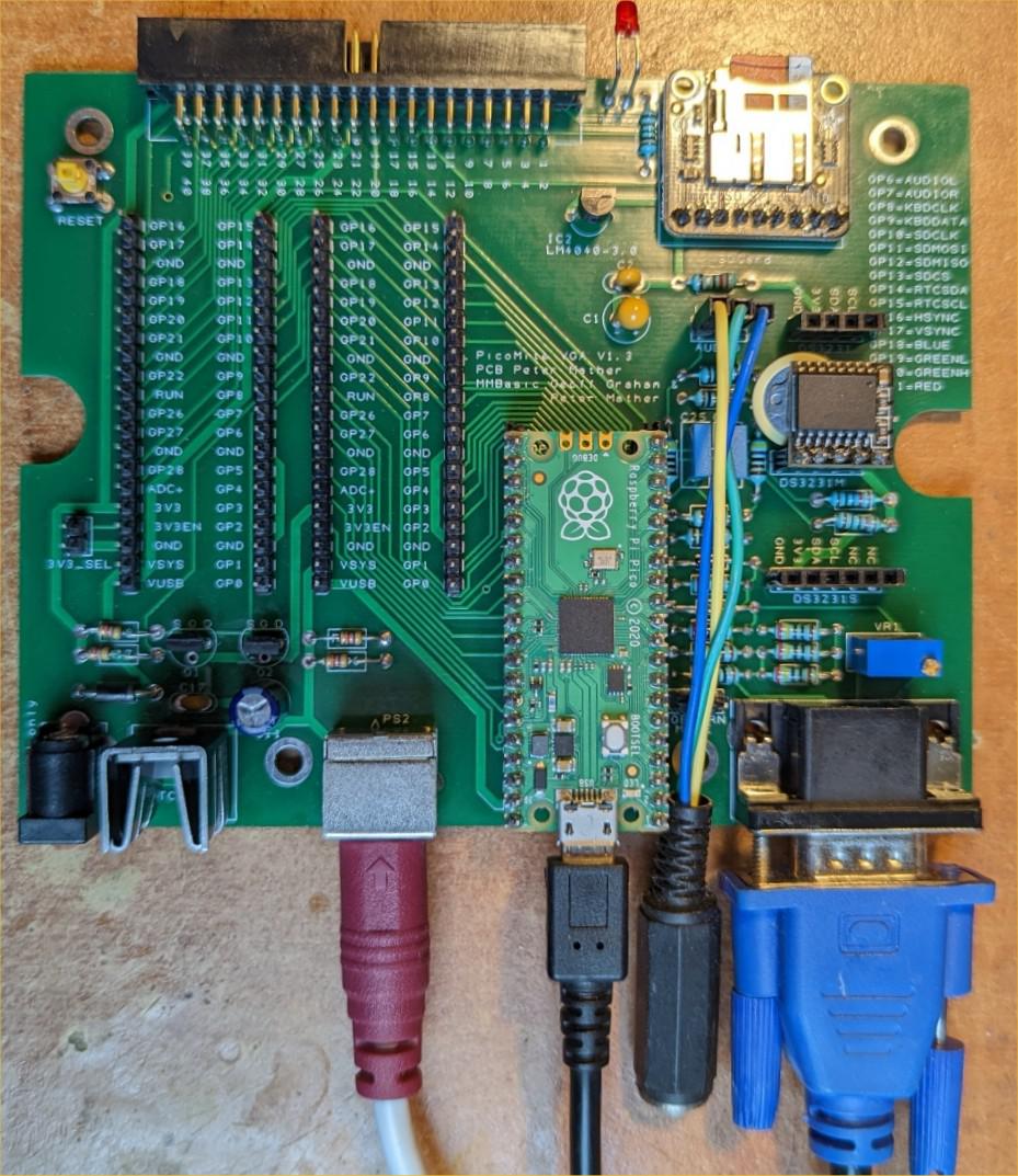

I'm not certain from the photo, but am I correct that the SD card breakout board is not attached to the PCB by a detachable pair of male and female 9 pin headers but instead it's permanently soldered to the board using just the male header ?

Posted: 03:17pm 03 Feb 2022
I'm not sure either, but soldering in the way you describe would certainly be more robust than using a female header. It's how I intend to mount SD card holders on my boards.

I already ordered one last week in China, but still waiting to arrive. Why are three RaspberryPi Pico header in parallel?
Posts: 3301
Posted: 10:20pm 04 Feb 2022
Peter added the two extra sets of pins so future internal modules could access any Pico pins. Making them the same footprint as the Pico means those modules could also be attached to a bare Pico.
Amnesie
Joined: 30/06/2020
Posts: 757
Posted: 11:37pm 04 Feb 2022
Thank you for the info phil! Great idea.
