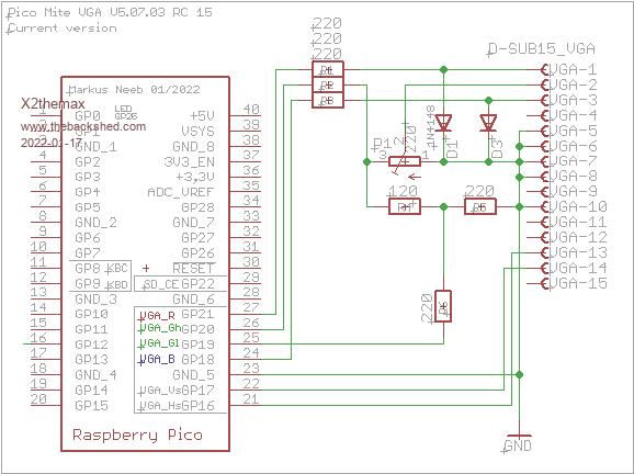

From Addendum to PicoMite Manual
VGA Wiring
pin GP16 to VGA pin 13 (HSYNCH)
pin GP17 to VGA pin 14 (VSYNCH)
pin GP18 220R to VGA pin3 (BLUE). 1n4148 from pin 3 , cathode to GND
pin GP19   R5 - see diagram below  (GREEN LSB)
pin GP20  R6  - see diagram below  (GREEN MSB / mono VGA out)<<<<<<<<<<<<<<<<<<<<<<<
pin GP21  220R to VGA pin2  (RED). 1n4148 from pin 1, cathode to GND
Connect GND to VGA socket pins 5,6,7,8,10

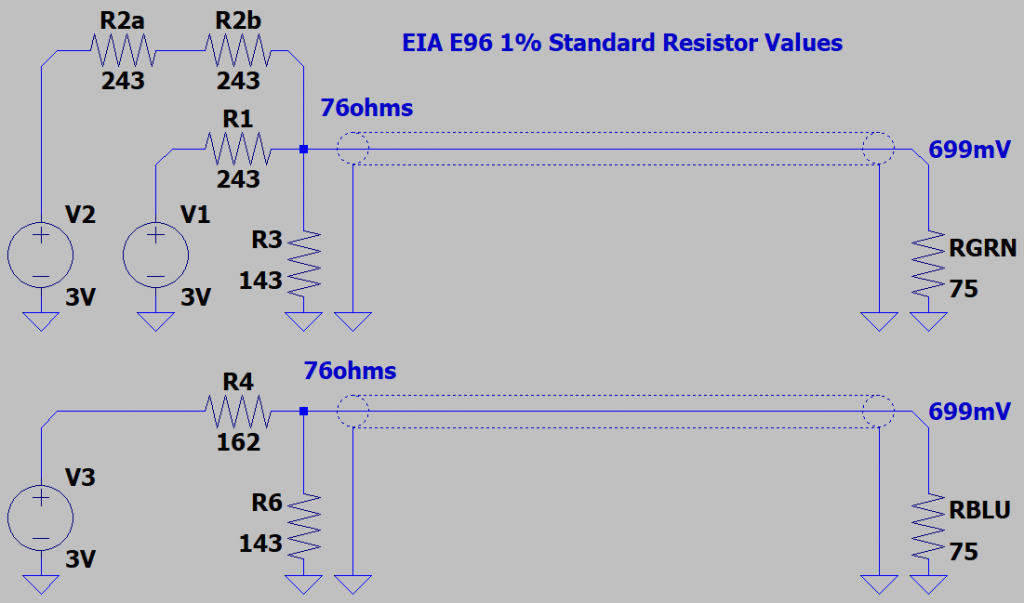

I think it's great to have a 5Euro BASIC interpreter computer with MM-Basic.

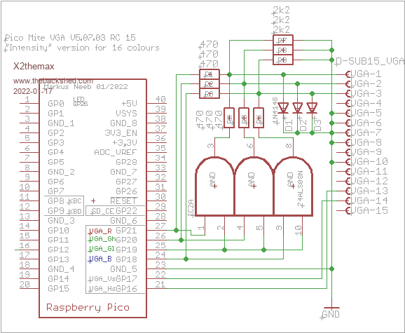

I have already built both versions of the Pico and have a few questions about the VGA version. (...and possibly a few ideas)
I do not understand the current structure with the colour correction.
Why do we need a green LSB and MSB signal ?
Is it right that we have only 8 colours ?

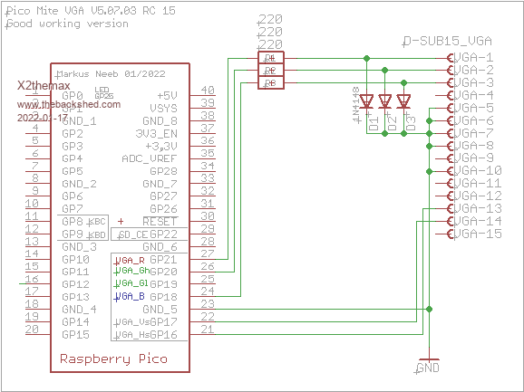

I figured out, that regular 220 ohm resisors and diodes are working very well for an acceptable VGA output with a good white balance:
Now my idea based on an intensity signal like the VDC of a commodore 128 with 16 colours:
In this version 3 AND gates are combining a intensity signal with each colour signal go get 2 shades of the same colour.
What are you thinking about it ?

Posted: 06:04pm 16 Jan 2022
Markus
The VGA code uses 4-bits for each pixel. I have called this RGB121 and it gives 16 colours if wired correctly. However, each "bit" could be connected in any way you like e.g 16-level greyscale using a 4-bit R2R DAC.
The firmware provides named colours that can be used for all 16 possible outputs and these represent the actual colours if wired RGB121.

Posted: 06:52pm 16 Jan 2022
Yes.
Other names would make sense with your idea.

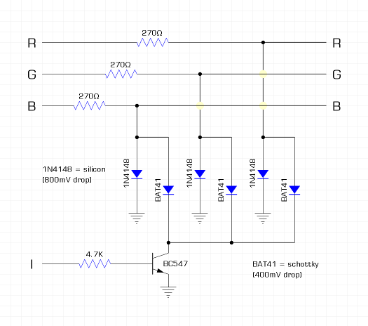

One possible way to map RGIB(1,1,1,1) (untested)
Re-map RGB(1,2,1) VGA to RGIB(1,1,1,1)
Colour to       Intensity       Mapped
Display         pin(GP19)      Colour
white           0               lilac
yellow          0               brown
magenta         0               magenta
red             0               red
cyan            0               cerulean
green           0               midgreen
blue            0               blue
black           0               black
white           1               white
yellow          1               yellow
magenta         1               fuchsia
red             1               rust
cyan            1               cyan
green           1               green
blue            1               cobalt
black           1               myrtle
DIM integer WhiteD(1) : WhiteD(0) = RGB(lilac) : WhiteD(1) = RGB(white)
DIM integer yellowD(1) : yellowD(0) = RGB(brown) : yellowD(1) = RGB(yellow)
DIM integer magentaD(1) : magentaD(0) = RGB(magenta) : magentaD(1) = RGB(fuchsia)
DIM integer redD(1) : redD(0) = RGB(red) : redD(1) = RGB(rust)
DIM integer cyanD(1) : cyanD(0) = RGB(cerulean) : cyanD(1) = RGB(cyan)
DIM integer greenD(1) : greenD(0) = RGB(midgreen) : greenD(1) = RGB(green)
DIM integer blueD(1) : blueD(0) = RGB(blue) : blueD(1) = RGB(cobalt)
DIM integer blackD(1) : blackD(0) = RGB(black) : blackD(1) = RGB(myrtle)
' usage: ColourD(Intensity) where Colour to Display = ColourD & Intensity = 0 or 1 = GP19
Edited 2022-01-18 17:32 by phil99

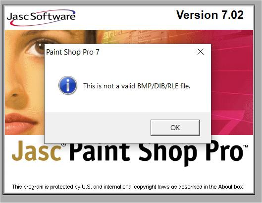

Posted: 04:16pm 18 Jan 2022
  X2themax said  ...and it works !
Great, but why not just show us the image rather than make us download the file, unzip it, and then, when I double-click on it, get "rgb.bmp It appears that we don't support this file format", or when I try to open it with PaintShopPro, get
Posts: 9329
Posted: 04:29pm 18 Jan 2022
Irfanview has no problem in opening either image, even direct from the zip file.

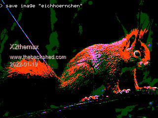

X2themax
Joined: 10/12/2021
Posts: 11
Posted: 10:57am 19 Jan 2022
OK -sorry- I will check it !

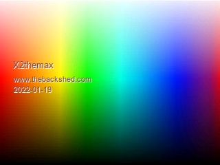

Here is the test image rgb.bmp:
Ok...
XnView opens the picture without any problems.
It is a reguar RGB-Bitmap and the Pico load this picture correct.
If you have any problems I try to post it again.
X2themax
Joined: 10/12/2021
Posts: 11
Posted: 11:13am 19 Jan 2022
You should now see the following on the Pico Mite:
Now all 16 colours are displayed.
X2themax
Joined: 10/12/2021
Posts: 11
Posted: 11:21am 19 Jan 2022
I forgot the following:
If you assign the GPIOs wrong, the two shades of green are reversed and the picture makes no sense!
It should work as above if you coose the right GPIOs.
The Second Image shoult be displayed like this:
I wish you all success !
