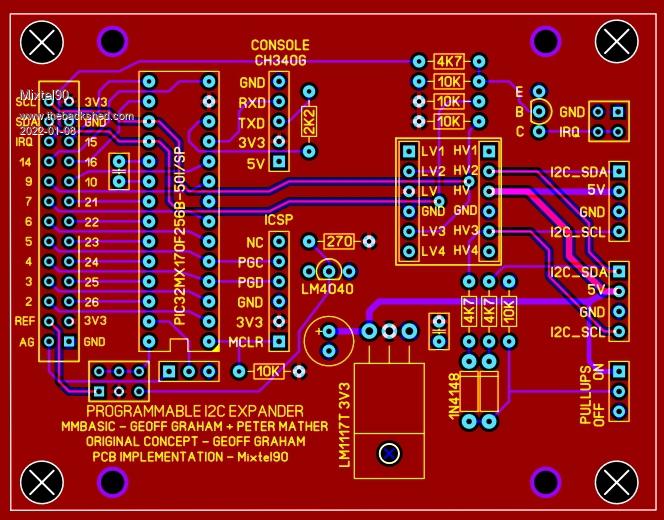

This is designed, with some end panels yet to be sorted out, to fit the 90x70x28 box.
I2C connection is looped through so that modules can be cascaded (but addresses will have to be set in firmware).
Supply and I2C is at 5V and the SCL and SDA lines are on the outside to reduce cable capacitance. This should allow operation over reasonable distances using ordinary 4-core flat cable. Powering at 5V also allows each board to have its own 3V3 regulator, taking the load off the SMPS on a PicoMite. Note that level shifting is needed if this board is connected to I2C lines that can't handle 5V. However, the 3V3 side I2C lines are available on the IO connector, the pullups are fixed on though.
An active high IRQ signal is available on the connector, which drives a cascadable open collector signal back to the host. No pullup is included as that will depend on the host.
Pullups on each board can be enabled/disabled from outside the case.
Links allow the analogue supply to be external, 3V3 or a 3V reference and the analogue ground can be linked to GND internally.
Any further ideas?

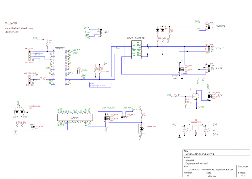

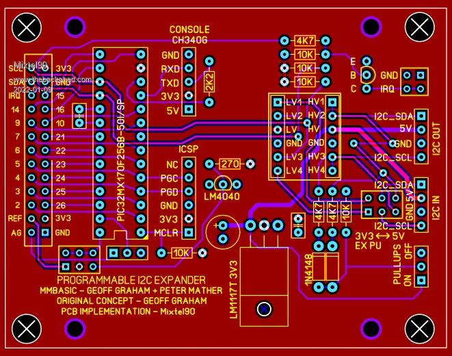

This version *should* be able to be driven directly by a 3V3 system. I2C IN has links to allow either normal 5V connection or spare inputs on the voltage shifter. Outputs from the shifter are paralleled up with the other 5V signals. There are no pullups when a 3V3 system is used as that would apply 3V3 back down the lines to a system that may be powered down. I don't know the circuit of the level shifter so I'm not *certain* about this. Obviously a 5V supply is still required to feed the 5V I2C to the next board.

Current circuit (it's probably about right):

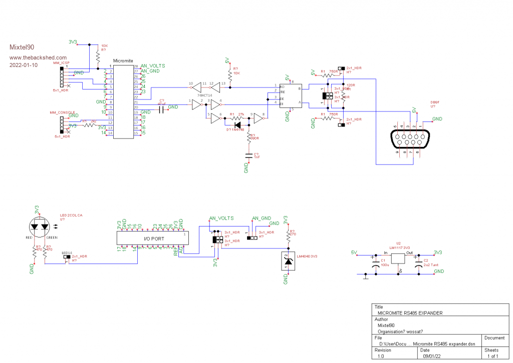

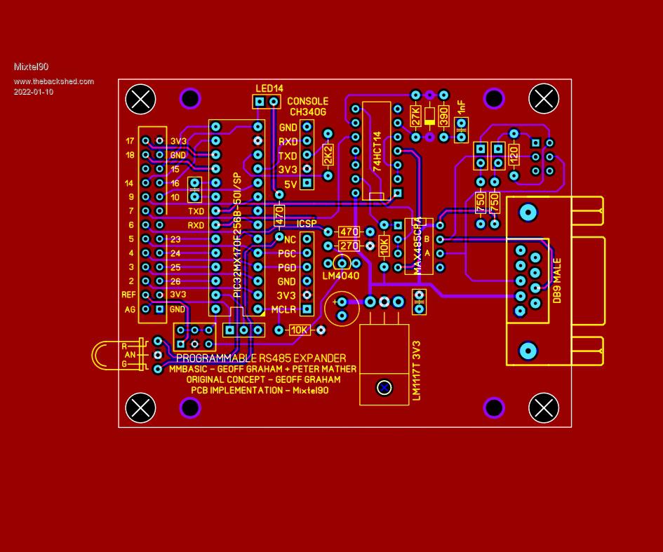

Here's an RS485 half-duplex version anyway. I *think* it might work. It has the same number of usable IO pins, but the I2C pins 17/18 replace 21/22 which are needed for COM1. Can't do a loopthrough if I use a DB9 as the box isn't big enough. :)
And just for completeness, here's the circuit:
Edited 2022-01-10 04:59 by Mixtel90
