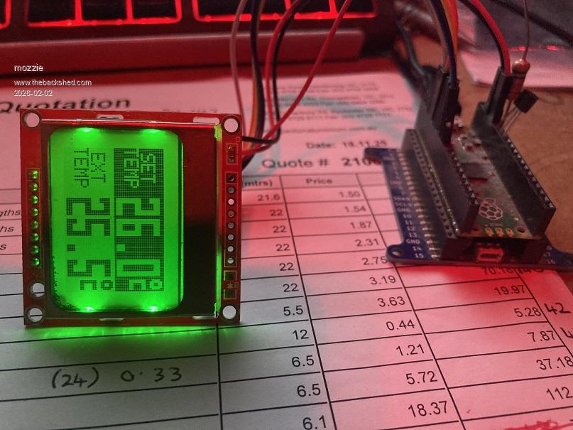

mozzie
Joined: 15/06/2020
Posts: 505
Posted: 01:49pm 01 Feb 2026
G'day All,
Peter, sorry to report it looks like Pluto may have stumbled on a bug. As he reported, if you use OPTION LCDPANEL RESET it:
Resets the PicoMite
Shows the startup banner
No further interaction at the console is possible.
Only re-downloading the firmware will fix it.
This is with N5110 and SSD1306SPI displays, haven't had time to test others.
PicoMite MMBasic RP2040 V6.00.02 is OK
PicoMite MMBasic RP2040 V6.00.03 is NOT OK
PicoMite MMBasic RP2040 V6.01.00 is NOT OK
PicoMite MMBasic RP2040 V6.02.00 is NOT OK
Same option list with all versions
> option list
PicoMite MMBasic RP2040 Edition V6.00.02
OPTION SYSTEM SPI GP2,GP3,GP4
OPTION COLOURCODE ON
OPTION LCDPANEL N5110, LANDSCAPE,GP5,GP6,GP7, 177
Also a big thanks for all the work on V6.02.00, haven't yet had a chance for some further testing due to this mad fire season here in VIC AUS.
Lyle.
Edited 2026-02-01 23:53 by mozzie
mozzie
Joined: 15/06/2020
Posts: 505
Posted: 02:15pm 01 Feb 2026
G'day WJSMarine,
These displays are great for low power and daylight readable applications.
I use the following connections and settings:
SCLK=GP2, DIN(MOSI)=GP3, D/C=GP5, RES=GP6, SCE=GP7
OPTION LCDPANEL N5110,L,GP5,GP6,GP7
And this to test the display with the temp from a TMP36 sensor on GP28
' Program to display temps on N5110 Display
' TMP36 sensor on GP28
' Deg C symbol is "(" in font 9
Option vcc 3.23
Option default integer
SetPin gp28,ain
CLS
 Settext
 For i = 1 To 5
   Settemp
   Pause 1000
 Next
 Box 0,0,28,24,,1,1
 Text 3,4,"SET",,7,1,0,1
 Text 0,12,"TEMP",,7,1,0,1
 For i = 1 To 6
   fgc=1:bgc=0
   If i Mod 2 = 0 Then fgc=0:bgc=1
   Text 28,0,Str$(20+i)+".0(",,9,1,fgc,bgc
   settemp
 Pause 1000
 Next
Loop while inkey$=""
Sub Settext
 Box 0,0,28,24,,0,0
 Text 3,4,"CAB",,7,1
 Text 3,52,"EXT",,7,1
 Text 3,28,"EXT",,7,1
 Text 0,36,"TEMP",,7,1
 Text 28,0,"25.4(",,9,1
'  Text 28,24,"41.2(",,9,1
End Sub
Sub Settemp
 Ctmp$=Str$(100*(Pin(gp28)-0.5),2,1)+"("
 Text 28,24,Ctmp$,,9,1
End Sub

And it looks like this when you change the backlight LEDS to green:
This font is designed to be easy for a blind old fart like me to read
Lyle.

mozzie
Joined: 15/06/2020
Posts: 505
Posted: 02:40pm 01 Feb 2026
G'day,
A few more notes:
The units here have a RED PCB and there are a few issues with these LCD's:
The PCB is too thin and warps away from the zebra strip, losing connection.
The PCB is not gold plated and the connections for the zebra strip will tarnish, losing connection.
The displays are either second hand / NOS or a second, I have a couple with odd pixels around the display area always black. (See previous post)
A few have been dead on arrival but repairable, occasionally they cannot be revived
Good luck
Lyle.
