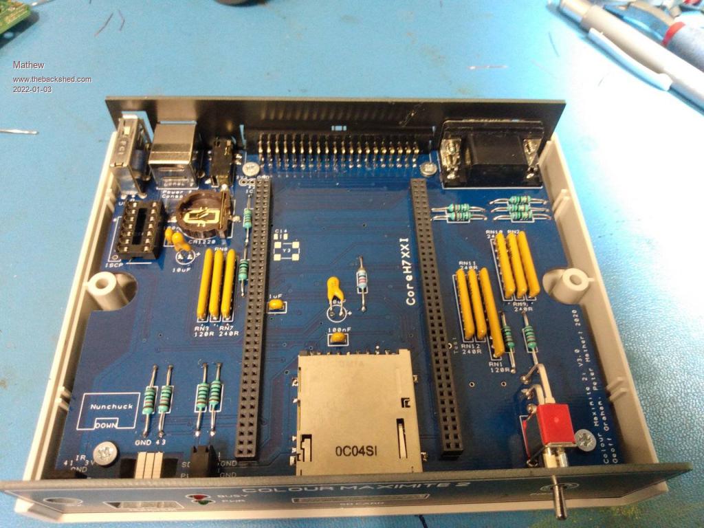

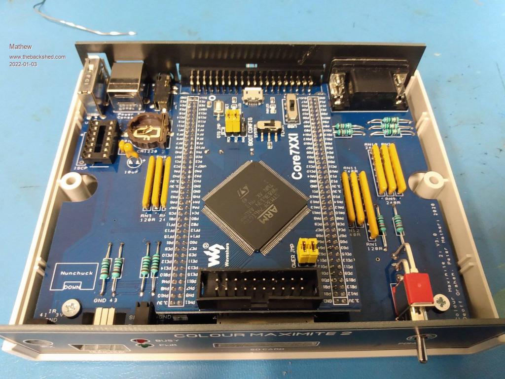

I was given a kit to build a Colour Maximite 2 and been having fun, but I seen to be stuck.
It is a v3 motherboard by Geoff Graham and Peter Mather, which uses resistor arrays. The kit came with 220 ohm arrays instead of 240 ohm ones, so I ordered some 240 ohm ones from eBay.
I am an experienced solderer, so I think I soldered everything correctly. Here are some pictures. It's in this state right now except I also populated the 14 point in socket in the top left.
I uploaded the 5.07 firmware I found online (with jumpers removed like the instruction said), put the jumpers back on, plugged the power and monitor in and turned it on. The power light comes on, but there is no output to the monitor.
Help would be appreciated.

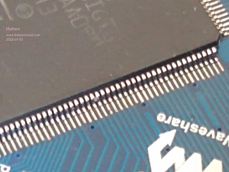

Looking at the waveshare, I notice what looks like a short between two legs of the main chip. This has me worried.
Posts: 9329
Posted: 03:35pm 02 Jan 2022
Will that bit of something shift with the aid of a pin or something? From your photo it doesn't look like solder.

My experience is the battery needs to be fitted to get it to power up.
I am concerned about the solder short on the wave share, you need to remove that, use solder wick and a hot iron but do not over heat the joints, if not moving, which it should. You could revert to a sharp scalpel but solder wick works well especially with some added flux.

I just noticed I have a Core7XXI, but the BOM calls for a CoreH7XXI. Could that be the reason it's not working?
Edit:
I just pulled up the specs of the boards and they are very different. The non H core is 216mhz, and 1mb flash. The H core is 480mhz and 2mb flash, for instance!
Edited 2022-01-13 09:23 by Mathew
Posted: 12:01am 13 Jan 2022
Oh!
That'll be the issue, I expect.
Edited 2022-01-13 10:02 by JohnS
