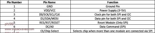

I think DO = Data Out = MISO and DI= Data In = MOSI, it is that way on other panels. SPI requires a clock (CLK or SCK) so that might be DC (Data Clock?), still leaving it a pin short. The puzzle is that it is usually Chip Select (CS) that is optional not Data Command (D/C).
I guess you will have to search the web for a data sheet for your exact panel.
To work it out by non-destructive trial and error put 390R in series with each of the 5 display pins and try all combinations.
Found this showing that it is MISO that is missing and DO is the clock.
Edited 2021-12-29 16:17 by phil99

Yea .. I found that also ...
Hence perhaps DC=A0=MISO ?

Posted: 03:08pm 29 Dec 2021
If the ssd1306sp can't be read from (e.g., with BLIT READ), then it doesn't need/use MISO. How the 'Mite configures the MISO signal should be irrelevant--it wouldn't be connected to the ssd1306sp. The absence of a MISO pin would seem to indicate that it's an input-only device.

Posted: 06:56pm 29 Dec 2021
You still need to specify the MISO pin, it just won't be connected to the SSD1306.
