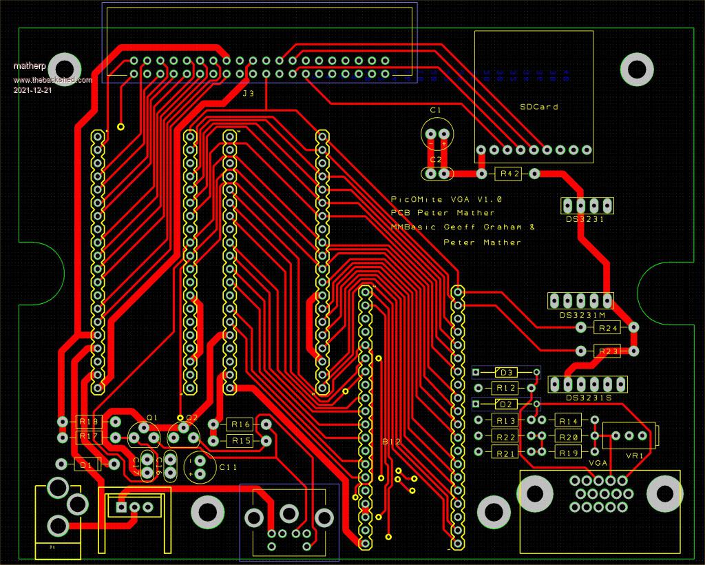

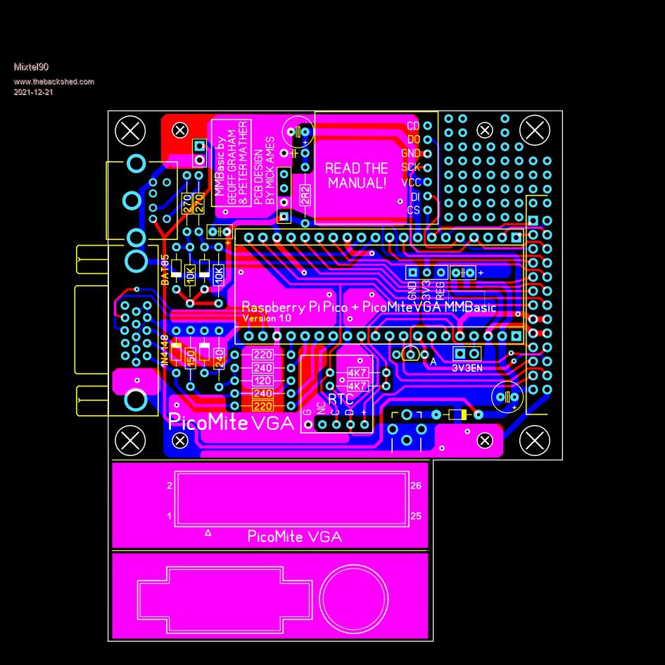

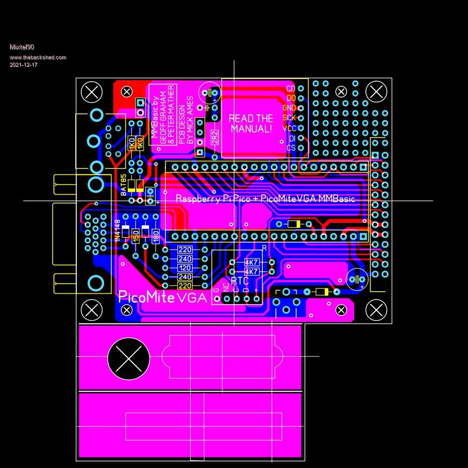

Provisional pic of pcb to fit the 90x70x28 case.
I've put a RTC on I2C2 and a SDcard on SPI.
RTC pullups can be omitted but I put them in just in case someone wanted to use the I2C without a RTC.
The 2-wqy and 4-way headers at the top allow a piece of strip or padboard to be added, running all along the top of the board if required. The 2-pin carries 5V/GND and the 4-pin has 3v3,GND and 2 spare pins for stability.
There are positions for a 3v Vref diode and a 5v input series diode if required.
Once again, 5v input is via a 3.5mm/1.3mm barrel jack.
I'm intending to try something different this time and notch the board myself to get the end panels included without paying extra. The idea is to use a 30 degree carbide V cutter in a dremel and use some sort of straight edge as a guide. We'll see if it works. :)

Posts: 3430
Posted: 11:56pm 16 Dec 2021
Very nice.
For the few keyboards that don't have their own pullups they can be put across the two BAT85 protection diodes. 10k should work.

perhaps a silly question - will the pico sit high enough that you can still plug into the USB socket to upgrade firmware?
none of the layouts put forward appear to have the pico orientated so it's 2 rows of pins are parallel to the 40-pin connector. if pins were wired 1-1 (are we doing this?) then that would lead to a far more compact layout.
rob   :-)
Posts: 9329
Posted: 07:26am 17 Dec 2021
phil:
I'm still playing. I had pullups on there at one point but then decided to use series resistors & clamp diodes - forgetting to put them back. :) I'll have another look round that area.
rob:
It does, just about, but not while in the case because the end panel blocks it off. This is one of the things I'm still sorting out - the mechanics of actually getting the thing into the case. If there's enough space over the IO connector I'll put a hole for a USB plug, if not then I won't. The barrel jack only needs a notch in the top and botom of the case. The SDcard, if the socket is spaced up by 1.6mm, can also be done with a notch in theory. I don't want to drill the sides of the case as it makes things difficult, which brings me nicely to USB socket access...
I used the parallel layout when I did my backpack PCB and it works well. However, in this case I already had a well advanced drawing for the Black Pill to work from so I've been carving that up. The parallel layout is great until you want to get pins out through the other side, then they always seem to end up in exactly the wrong places. lol. e.g. in this case PS/2 is on the opposite side to VGA and there are insufficient pins on the VGA side for an SDcard unless you lose the analogue pins. I always like to run the analogues together too, away from digital noise if possible.
On PS/2 input protection:
In simulation, series resistors of 270R are needed to pull 10k pullups down to 0.5v, remembering that PS/2 is bi-directional. The BAT85 is a small signal schottky type and has a very low Vf at low currents. There's only about 300uA of input current to be sunk in total and the input is, in theory anyway, at less than 3.5v which is nicely within the 3.6v continuous limit - and the current is limited to 150uA anyway. This may not give full protection if a device is connected that forces 5V into the PS/2 as the input will go up to 3.8v, but this shouldn't happen. My only reservation is that there are some PS/2 mice that are not oc output and someone will probably try one eventually.
Incidentally, I originally had a link to select 3.3v or 5v for the keyboard. However, I checked on keyboard current consumption and the PS/2 spec allows over 250mA for a keyboard. The one I have connected to the CMM2 is 100mA. In view of that, and the fact that the PicoMite SMPS gets noisier with increasing load, I decided to keep the keyboard at 5v.
Edited 2021-12-17 18:30 by Mixtel90
Posts: 9329
Posted: 10:23am 17 Dec 2021

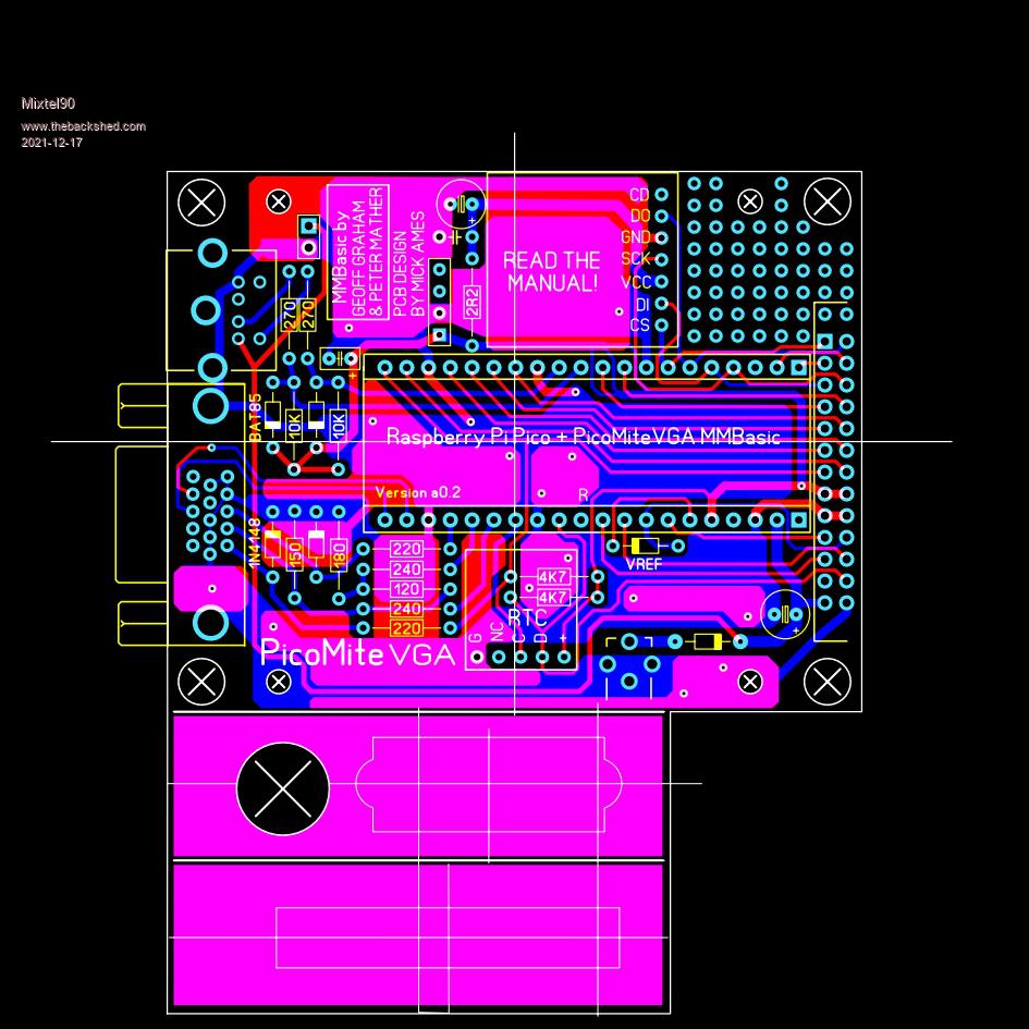

Version a02
VGA sorted out in line with Peter's correction.
PS/2 pullups added & series resistors reduced (after simulation).
VREF diode moved & now on AGND to reduce noise.
Additional GND added next to 5v pin.
Some general tidying up.
Wondering if it's worth squeezing in the bits for a (SMD) linear voltage reg...
What shall I use the spare IO pin for?
You never actually *finish* a pcb design, do you? You just send it for manufacture. :)
Hopefully I'll be able to sort out the mechanical side shortly and correct the cutouts in the end panels.

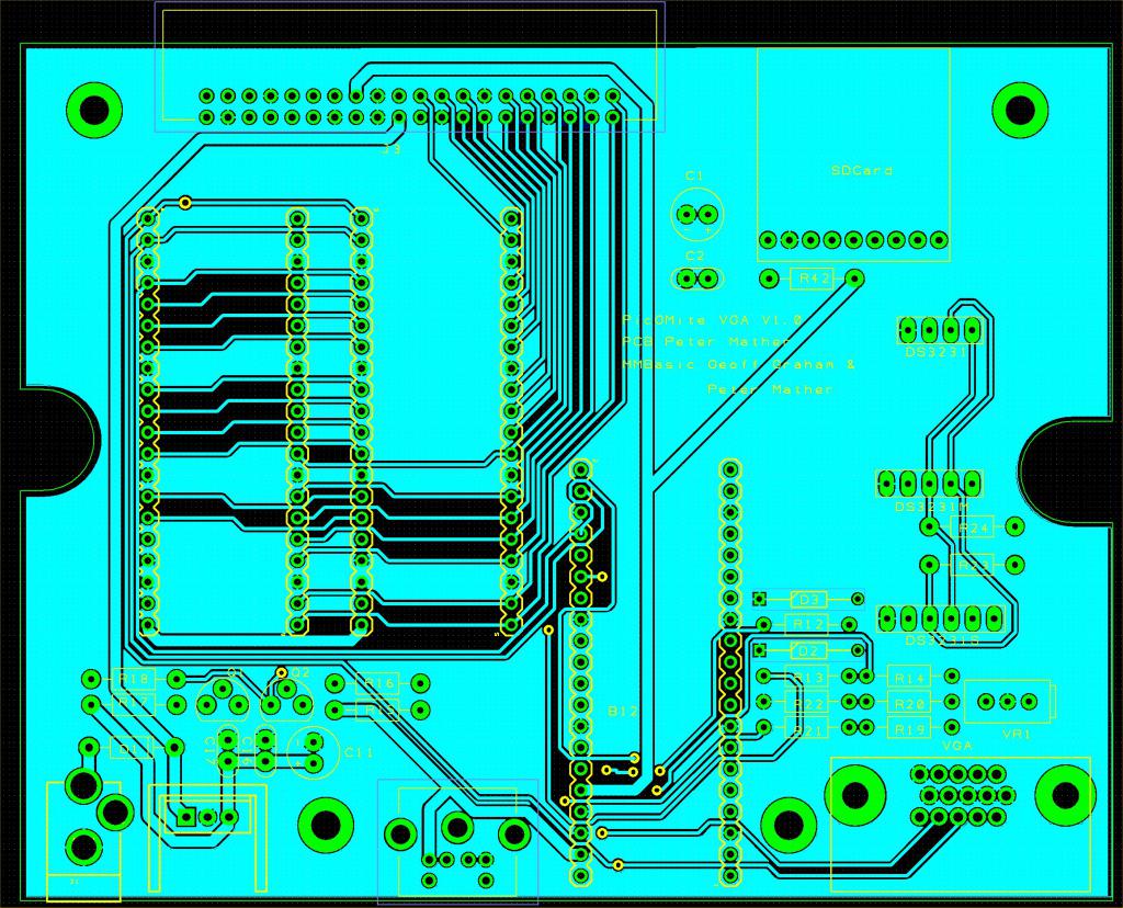

Posted: 03:05pm 20 Dec 2021
Here is my take on a PCB for the PicoMite VGA using the normal Maximite box
VGAMite - Project.pdf
The Pico protrudes to the back panel so the board can be powered by the Pico USB or alternatively you can use the 2.1mm jack (supply still must be 5V). The power is a full size TO220 linear low drop out regulator (TC1264-3.3)
TYhe board has two slots for Pico Shields allowing for things like GPS or ESP8266. There are footprints for both the widely available DS3231 modules
SDcard is the Adafruit 3V module so there are NO SMD COMPONENTS.
I'm using a proper level shifter for the PS2 allowing the keyboard to work off 5V
The green VGA signal uses a R2R DAC with 220R resistors (2 in parallel to give the one 110R needed). There is then a trimmer to match the full green level with red and blue
The 40-pin front panel connector uses a 1:1 pinout with the Picomite to keep things easy.
All track widths and clearances are easily within the requirement for the cheapest PCB manufacture at JLC
Posts: 9329
Posted: 03:27pm 20 Dec 2021
Nice! :)
You must have been reading my mind. :)  I added the option of using a linear voltage reg this morning before I went out, but mine is SMD and mounted underneath the PCB. It's general purpose, optional and connection is by links so it could be used to power a ESP8266-01S rather than use the PicoMite SMPS.
Now upped to version 1.0 as I don't think I'll take this much further unless I find a problem. Added Reset to the IO connector and changed VREF diode pads so it fits better. I've just tipped the SDcard capacitor on its side too, allowing easier component placement on the expansion board if it's used.
Gerber files if anyone is interested:
PicoMiteVGA10.zip
