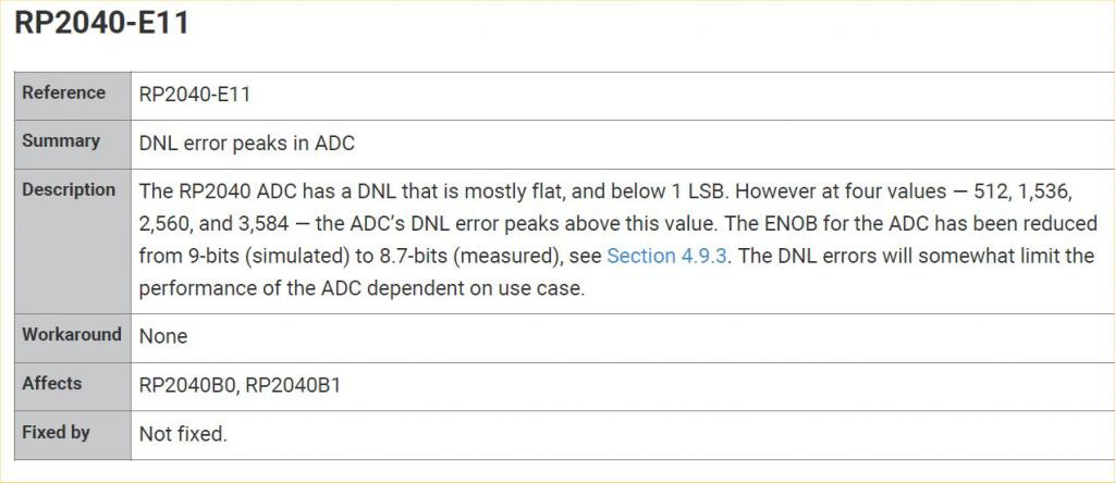

But now I see a new problem: Why are some measurements identical up to the last digits, then jumping by 0.4 degrees back and forth? Looks like some strange quantisation inside the temperature measurement Pin(temp)?
-andreas
Edited 2021-12-18 20:12 by andreas
Posted: 10:30am 18 Dec 2021
From the RP2040 errata
Differential nonlinearity (acronym DNL)
Effective number of bits (ENOB)
Solar Mike
Joined: 08/02/2015
Posts: 1255
Posted: 11:20am 18 Dec 2021
Not helped by the ADC reference being a very noisy 3.3v switching supply; I have had to use a LM4040 shunt reference connected to the ADC Ref pin to get more stable results. Even better turn off the internal 3.3V switcher and use an external 3.3V linear regulator. Kind of defeats the use of a cheap CPU...
Mike
