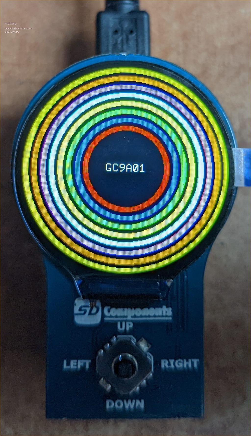

V5.07.02b0
Support for 1.28" round GC9A01  240x240 display as requested by Lewis
Picture does not do the display justice. It is crystal clear and bright, with an excellent viewing angle
Configuration for this display. NB: it doesn't use MISO so no BLIT or transparent text and uses (abuses) GP12 which is normally MISO
OPTION SYSTEM SPI GP10,GP11,GP28
OPTION LCDPANEL GC9A01, LANDSCAPE,GP8,GP12,GP9,GP13
Backlight is on GP13 and works conventionally (100 is full bright)
Edited 2021-12-15 20:17 by matherp

  matherp said  Support for 1.28" round GC9A01  240x240 display as requested by Lewis
A thing of beauty but at an eye watering price.
Do you write to it as if it were a square 240x240 display and it just ignores pixels that are out of field ?
Edited 2021-12-15 20:26 by thwill
Posted: 10:31am 15 Dec 2021
  Quote  Do you write to it as if it were a square 240x240 display and it just ignores pixels that are out of field ?
Yes
  Quote  A thing of beauty but at an eye watering price.
It could be yours for free
