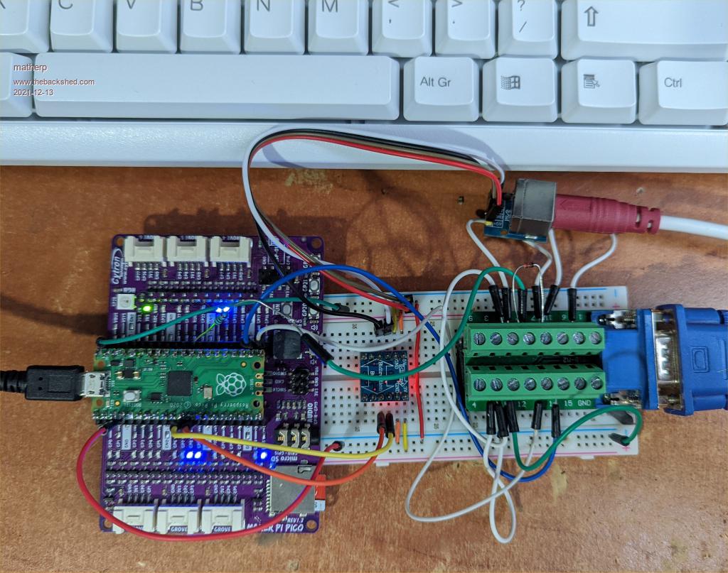

Please find attached the first beta for the PicoMite VGA Edition.
PicoMiteVGAV5.07.01b0.zip
Special thanks to Miroslav Nemecek for the code used as the basis of the VGA driver. This runs exclusively on the second processor and has little of no impact on MMbasic performance.
The only compromise is that the display has to be blanked when writing to flash as this can only happen with interrupts disabled. How fast the image returns depends on how fast your monitor re-establishes lock.
This happens when exiting edit, exiting autosave, changing options, using VAR SAVE or using FLASH commands that write to flash. Otherwise the image seems very stable and clear.

Wiring:
VGA
GP16 connect to VGA socket pin 13
GP17 connect to VGA socket pin 14
GP22 connect to VGA Socket 1, 2, or 3 via 220ohm resistor
Connect 1n4148 diode anode to VGA socket pin 1,2,or 3. Connect 1N4148 cathode (bar end) to GND
Connect GND to VGA socket pins 5,6,7,8,10
PS2 Keyboard
IMPORTANT
use level conversion between the Pico pins and the PS2 socket or run the keyboard at 3.3V
Connect GP8 to PS2 socket CLOCK pin via level converter (tested with this one)
Connect GP9 to PS2 socket DATA pin via level converter
Connect VBUS to PS2 socket +5V
Connect GND to PS2 socket GND
Enable the PS2 Keyboard with OPTION KEYBOARD

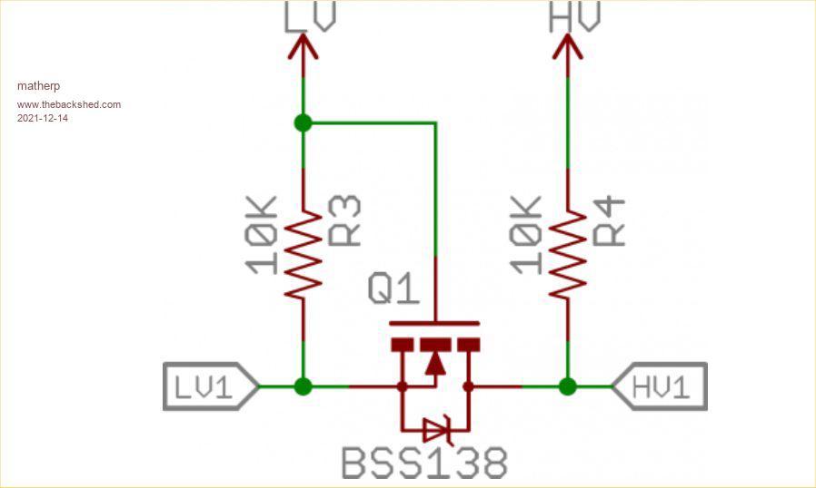

Posted: 08:53am 14 Dec 2021
Much better to do the level change properly
a cheap mosfet and two resistors. i.e. the incremental component count is two resistors and two mosfet

Posted: 09:12am 14 Dec 2021
Cheap and simple:
https://www.amazon.de/dp/B095H64XSV/ref=sspa_dk_detail_3?psc=1&pd_rd_i=B095H64XSV&pd_rd_w=TVsAE&pf_rd_p=4f2ceb27-95e9-46ab-8808-db390b56ec01&pd_rd_wg=xG8a0&pf_rd_r=62A0MCG80D7JKGGZN0N9&pd_rd_r=21b1da41-bc76-45e7-b7e7-2651a71b7f82&spLa=ZW5jcnlwdGVkUXVhbGlmaWVyPUEzRFFBSVVJMzVQVkY0JmVuY3J5cHRlZElkPUEwMDA0MTIzMkhPVVM3VVM5NUhYNSZlbmNyeXB0ZWRBZElkPUEwODQ1NjYyMUZHTUo3RkFZV1o4TyZ3aWRnZXROYW1lPXNwX2RldGFpbCZhY3Rpb249Y2xpY2tSZWRpcmVjdCZkb05vdExvZ0NsaWNrPXRydWU=

Posted: 09:31am 14 Dec 2021
Both perfectly valid, but a proper level shifter is overkill for a PS/2 keyboard. :) All you really need are two zeners - the pullups will limit the current. Neither side is supposed to ever apply their supply voltage to either pin - from a hardware perspective it's I2C where the keyboard is the master. Any pullups built into the keyboard will tend to be between 1k and 10k so there's not a lot of zener current.
