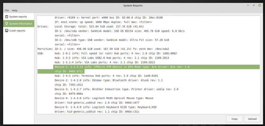

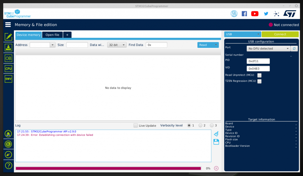

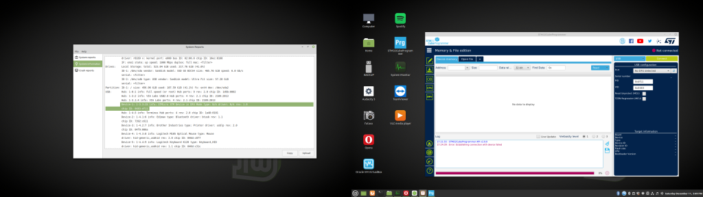

Anyway, I installed the Cube programmer for Linux just fine, it runs just fine in Mint, but it refuses to talk to a Black Pill module.
Interestingly, Mint itself CAN see the module, as confirmed by getting a system information report - see this image:
Note that the Cube programmer is looking for the DFU with a PID of 0xdf11, and a VID of 0x0483, and that Mint sees the Black Pill module in DFU mode, with EXACTLY those settings - but Cube Programmer just says that no DFU was detected.
I have highlighted the Black Pill module as seen by Mint in green in the left-side image, so I would have thought that at this point - if Mint can see the module with the correct PID and VID, that the Cube programmer should also be able to see the module at this point.
Weirdness.....
Any ideas?
I will update this thread if I ever get a reply to my request to join the ST forums, but as yet....nothing.
EDIT: Image is too fuzzy and cropped for you to be able to read any of it.  I will try to crop the image into two separate ones and upload them here.

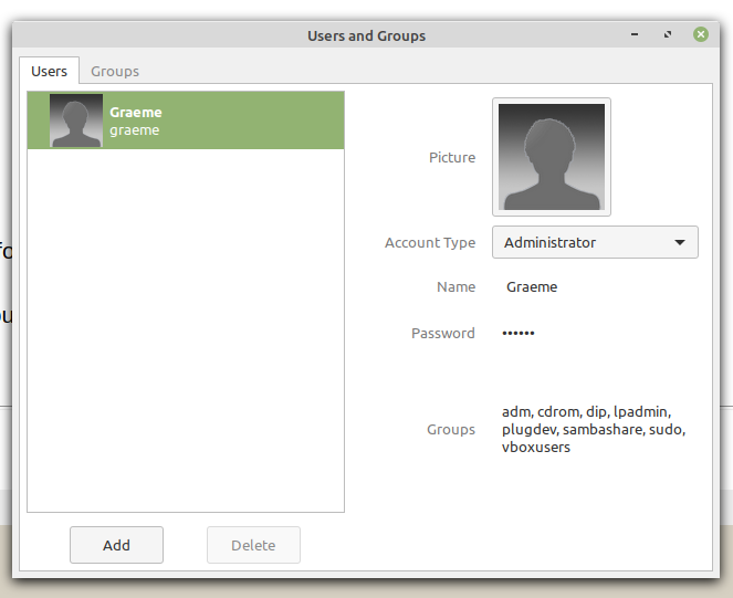

Have you given yourself permission to use serial ports (modems)?
Posts: 10109
Posted: 06:51am 11 Dec 2021
NO.
I have given myself permission to use the USB flash-drives etc, to get USB flash-drives and printers working inside the XP VM.
If you can give me a console command I can run to give myself those permissions, that would be fantastic.
Posted: 07:00am 11 Dec 2021
Using the GUI
start
Administration
Users and Groups
select the user
Advanced settings
User privileges
Put a tick in Use modems
You might have to log out and back in for it to take effect.

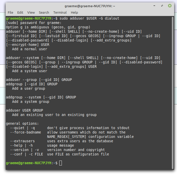

Posted: 01:49pm 11 Dec 2021
  robert.rozee said  hi grogster,
   to add the current user to the dialout group:
sudo adduser $USER dialout
rob   :-)
I think you'll need
sudo adduser $USER -G dialout
(using -G not -g)
Try
man adduser
to read the manual page.

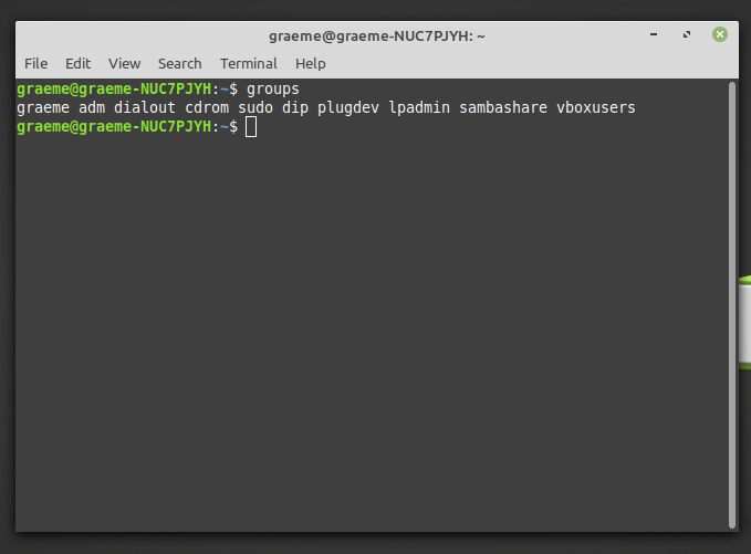

Posts: 10109
Posted: 03:53am 12 Dec 2021
Hi John.
This is the response I get:
Posted: 04:40am 12 Dec 2021
You were missing the -a switch
or
sudo usermod -a -G dialout $USER
The first version is specific to Ubuntu and derivatives
The second version should work for all Linux
and
groups
should list the groups you are in.
Edited 2021-12-12 14:42 by TassyJim
Posts: 10109
Posted: 10:38pm 12 Dec 2021
Thank, I have added that, and that command was successful.
Cube programmer still flatly refuses to talk to the module, or even see it at all.
Does anyone else have anything else they would like me to try?

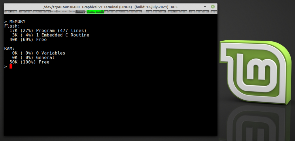

This is interesting.
I was expecting Linux to assign it to a folder in the tree as it does with something like the E28 module, and then I could point the Cube programmer to that location, but it does not show up as any kind of USB device at all as I was expecting.
I'll dig out an E28 and connect that, just to make sure that Mint is actually doing what I would expect in the first place.
EDIT:  Yep, an E28 module shows up fine on the expected path, and I can talk to that just fine via GFXterm for Linux.
So, it has to be still something else I/we need to find out that is blocking Cube programmer from being able to see the Black Pill module.  For a test, I will now connect a CMM2 and see if the Cube programmer can see that.
EDIT: Just tried plugging in a Picomite module for a quick test in upload mode, and Mint sees that just fine and treats it like a small USB flash drive as you would expect, so that's good.  Mint also assigns it /dev/ttyACM1, and I can talk to the Picomite with GFXterm for Linux also, so I think everything is working OK at the USB side of things.
