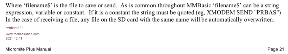

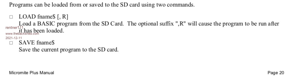

I think then the error message is not correct either? Shouldn't a "syntax error" be displayed? Whereby it works with "SAVE Fname $, and the documentation says the following in 2 places:
Is a little confusing to me?
Posts: 9329
Posted: 06:43pm 10 Dec 2021
Immediately prior to LOAD "filename".R being executed a NEW command has also been executed. Consequently there is no error to trap, unless it is something wrong in the line "LOAD "filename",R".
Note that when using the ".R" option "filename" has to be a literal because the NEW destroys all variables. You can't LOAD fname$,R because fname$ has been destroyed. As it is now a null string it can't be found so LOAD will return a "File not found" error. There is no problem with the syntax.

Posted: 08:47pm 10 Dec 2021
  rentner111 said  Hello !
Your second quote is from the XMODEM description.
You seem to have taken 'common' to mean 'in every instance' rather than 'very often'
LOAD is a special case because it is meant to be used on the command line, not in a program.
