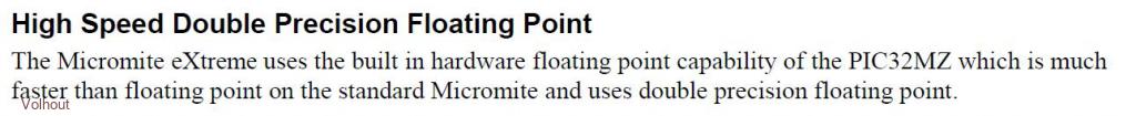

On the Maximite (CMM1) the floating point numbers are single precision, as are the integers
On the Micromite (MM2, MMplus) the floating point numbers are single precision, the integers are 64 bit.
On the Micromite Extreme double precision floating point numbers are introduced.
