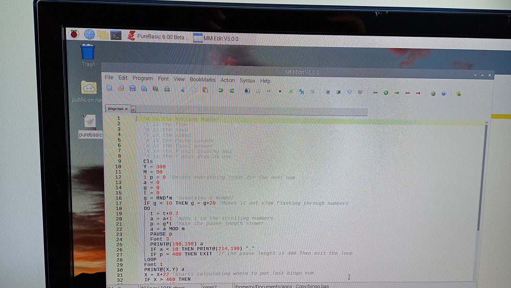

MMEdit V5 is getting close.
This is the Raspberry Pi version. Almost working.
There is a lot to do around serial port names etc.
I will have a 64 bit Linux (Ubuntu) version and Windows 32 and 64 bit.
It is still in beta but you can have a play.
https://www.c-com.com.au/stuff/MMedit5_portable.zip
Windows 64 bit only for now.
I have divided the program into 2 parts.
The editor should be familiar.
The "Maximite Control Centre" does all the connecting to serial and TCPIP

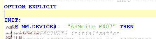

2/ A labels called "INIT:" is seen as a token (command/function) where this function correctly in the MMBasic on the MMites involved.

I will remove INIT from the keyword list.

Posted: 10:57am 30 Nov 2021
Yes, Purebasic as seen in the toolbar
PB is changing to C as it's compiler which will make things like RPi easier to achieve.
You have to compile on the target system - not cross compiling (yet)

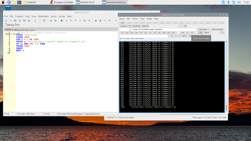

MMEdit working on my RPi.
Still a lot of work to do but I am pleased to have got this far
The ZIP contains a .gz file with the required files.
Extract it to any convenient location and play.
It works on the latest Raspberry OS. Not sure if you will need any dependencies or if it works on older versions of the OS.
RPI.zip
(I had to ZIP it to upload here)
The first line of the BAS file is
'target port\ttyACM0:115200 s\picomite
Load a file,
put an appropriate 'target line in and
click on the lightning bolt icon (far right of toolbar)
It should open the MMCC and connect and load the BAS file.
An alternative method is to open MMCC and configure a port.
Connect to the 'mite,
in MMEdit or any other editor,
'select all' and drag it onto the terminal window of MMCC.
The Ubuntu version will be a day or two...
Along with some operating instructions.
