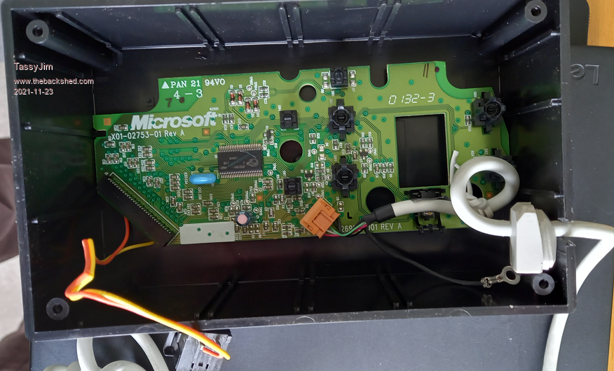

A few years ago I had a desire to send a small string to a PC so I butchered a keyboard and used the keyboard IC to do the heavy lifting.
I just traced the circuit board to find out which pins needed shorting for the desired keys. One incarnation used a micromite to 'hit' the keys in the right sequence.
This version has a simple pushbutton.

That is clever. Perhaps you don't need to butcher the keyboard. Run a ribbon cable in the back to the desired PCB tracks making it dual purpose.
