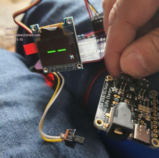

I wanted to make a small GPS speedometer for the dash of my car because I'm sure most of you know the speedometers are not calibrated
They can be up to 10% in error of the speed, reading lower than what you're actually doing.
I chose the Picomite because of it's small size, I had one here, Simplicity and it could do everything I wanted
I used an 0.95" 96x64 SPI Full Colour SSD1331 OLED LCD Display Module but the second board I have coming from China will also be compatable with
the 0.96" ST7735S 80x160 SPI Colour IPS TFT LCD Display Module

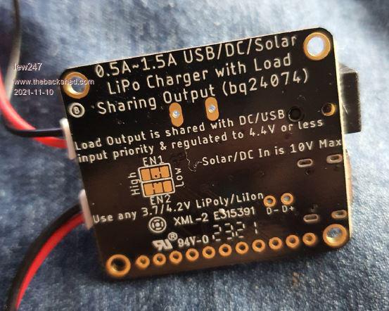

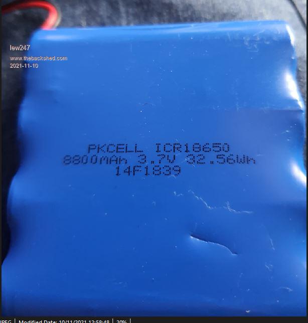

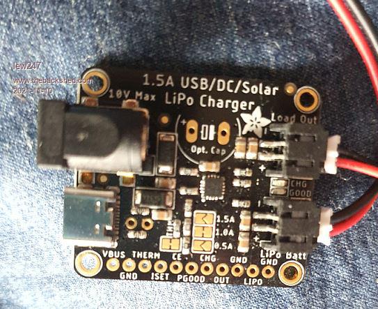

The unit is powered in my instance by a 6800mAh Lifepo4 battery pack, which has a Solar Charger attached and a 6v Solar panel
The solar panel charges the battery even with a fully cloud covered sky in the UK and as the unit has enough battery power
to power it for 90 hours with the cpu at full speed and the unit running continously then it should run forever (or many years)

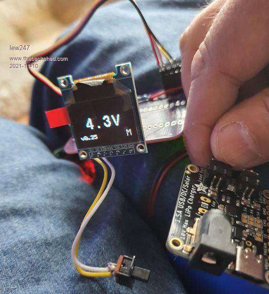

The display shows the battery voltage on start up and if the voltage drops below 3.2V then the K and M indicators are
replaced by a B for battery.

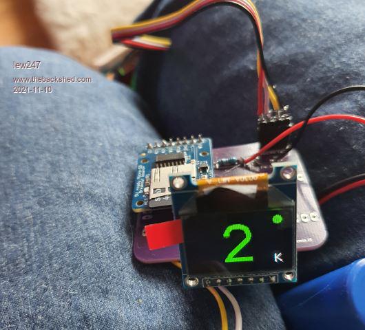

Once it has a valid satellite lock there is a green dot on the top right corner of the display indicating a valid GPS lock
There is also an M and K indicator at the bottom right to indicate if the speed is MPH or KPH
I have a switch wired to the Pico this lets you select MPH or KPH
I used this because I sometimes drive to Ireland which uses KPH, if you only use one and not the other then the switch can be omitted

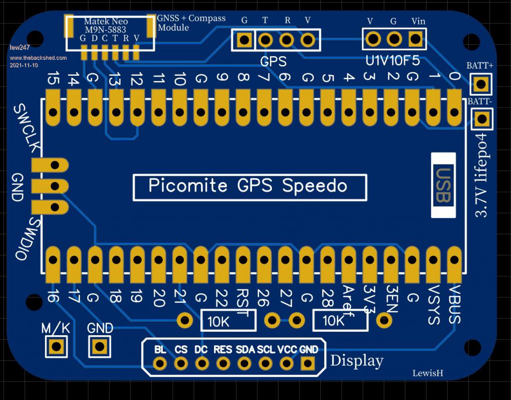

The new board that is coming doesn't have the SD card you can see in the pictures below because it isn't needed

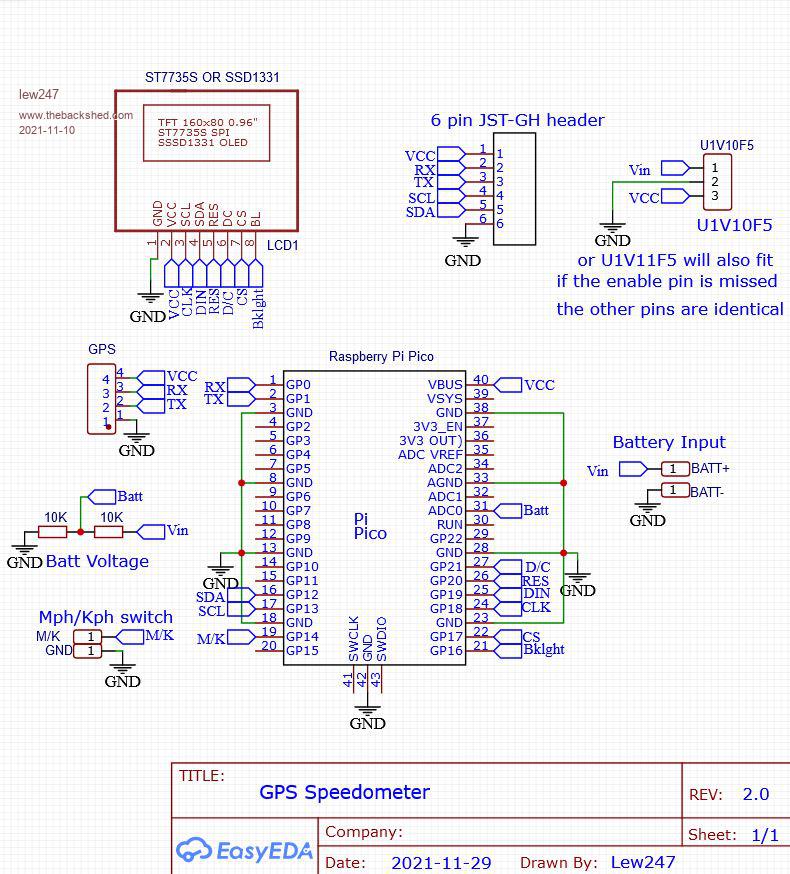

I added a connector for a U1V10F5 battery to 5V buck convertor
An U1V11F5 will also fit if the enable pin is missed, the other pins are identical
They both boost the voltage to  5v output from any input from 0.5V
The board has 3.7 Lipo4 battery only written on it but I put that on the board before I decided to use the new power up module
This means the unit can be run on any battery from 0.5v up
as long as the voltage isn't over 5V

This is the circuit for the updated board with support for both displays
It does not have an SD card as it isn't needed for this project
This looks really messy as it's sat on my lap and I don't have any kind of case to put it in yet.
Power up display
After Voltage reading but waiting for a valid GPS lock
GPS lock with MPH
GPS lock with KPH
Battery pack
Solar charger
back of Solar charger

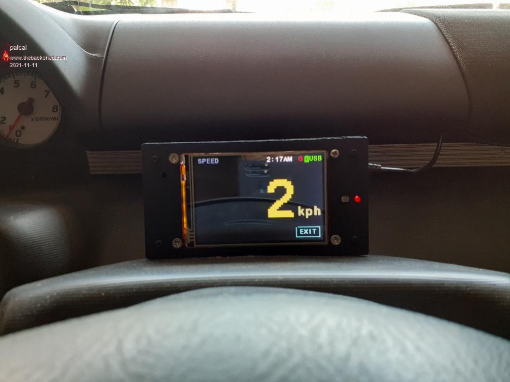

I made a GPS speedo for my car, I just plug it into a USB charger in the cig. lighter.
