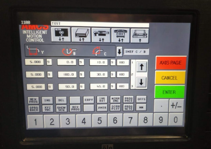

I was just wondering if it was anything like the old PCOPY that was possible with EGA.
On a dog of a 12MHz 80286 (DOS/QuickBASIC), I had some really snappy GUIs. I suspect that some of my BMPs are going to be too big for the PicoMite's memory. No biggie.
Circa 1988:
Posts: 3881
Posted: 01:56pm 10 Nov 2021
  Tinine said  I suspect that some of my BMPs are going to be too big for the PicoMite's memory
Nice screen. If your number buttons are individual BMPs, you might be able to have one blank BMP and overlay it with a smaller number BMP. (But I'm sure you'll figure it all out.)
