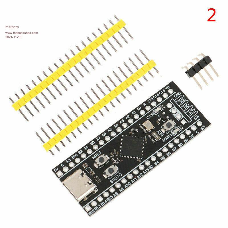

The "Blackpill" has been around for some time and is a very cheap DIL module with an STM32 processor. There are a number of processors available but the interesting one is the STM32F411CEU6
Basically the same size as the Pico, a little bit dearer but a much more conventional chip (onboard flash, lots of timers, a great IDE, and I know the F4 inside-out)

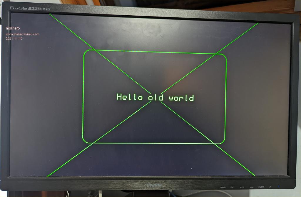

I've been playing with a mock-up of things I could do with this chip
The attached image shows it running a 640x480 VGA display using one resistor and one diode
It would be possible with a relatively small amount of work, taking code from the ArmmiteF4 to create a first gen style computer but with a modern language running at a 100MHz clock speed. The Blackpill includes space on the underside for a flash chip which if fitted could be used as a file storage device with no need for a SDcard. This approach is already used on  the ArmmiteL4.
I would implement a PS2 keyboard (like the Maximite) so that you could program completely stand-alone or you could use a serial console as per the Micromite.
Due to memory limitations in order to get a nice display it would be monochrome. There would be around 64K of variable memory and the same again for a program stored in the processor
The 48-pin 411 supports 10 12-bit ADC and would probably have something like 2 or 3 uarts 2 SPI, 1 I2C 5 PWM and the usual count/frequency input/IR etc.
The video generation as displayed is created using an SPI output under DMA so has very little impact on performance.

Is it this one ?
Sounds like it would be great - they're very cheap and plentiful I think.

I'm guessing it's this one...

I'll make up for it. More info on board here. It looks like a nice little board. The PS/2 keyboard lovers would be happy, the VGA lovers would be 1/3 happy and the SDcard lovers might not be too happy. It would be handy having more analogue inputs than the PicoMite sometimes. A single I2C looks limiting at first, but you don't need one for a RTC in this case. Looks good. :)

It is somewhat reminiscent of Hercules Graphic (but 720 x 348) ...
I like it!

The world of "Blue Pills" suffers from fakes and semi-working copies.
I haven't heard of "Black Pill" fakes yet but it is something to keep in mind. Otherwise, sounds useful.

  vegipete said  The world of "Blue Pills" suffers from fakes and semi-working copies.
It's a WeAct Studio board, and they do struggle with fake copies.
You can read aboute it on their GitHub page
This is a fake board
This appears to be genuine
As a rule of thumb - if the seller doesn't show a picture of the bottom of the board, it's most likely a fake.

  jaybek said  This is a fake board
How do you conclude that? Bottom of the board is shown further down the page. (I have no idea myself whether it is genuine or fake, or what the characteristics of a fake might be.)
  Quote  This appears to be genuine
What's for sale there isn't even an F411.

  Quote  How do you conclude that? Bottom of the board is shown further down the page.
Yes, that's right it's shown - just not with right logo
  Quote  What's for sale there isn't even an F411.
There are two different boards for sale. One of them is a F411
I think you have the fake and genuine back to front.
The genuine should have V3.0 under the logo.
But much safer to buy direct from the WeAct aliexpress store.

Real or fake, I bet there are very few actual manufacturers of these boards. It's even possible that they might even all come out of a single factory but with slightly different build specs for different customers. The factory won't care. WeAct almost certainly aren't the manufacturer.
If the chip is genuine or a good clone then the boards will be virtually identical, no matter what WeAct Studio say, as the board is basically the chip wired out. The main thing is that WeAct don't want a whole load of complaints about any bad clones making their product look bad, which is fair enough.
The same thing has happened with the Arduino boards, you'll be hard pressed to find a Chinese clone that is any worse than an original Arduino.
