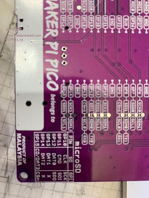

is there anybody out there, who can tell me how to asign the correct pins with
OPTION SYSTEM SPI.........

but with this Board the pins are routed to fix Port, see Picture above.
So it is not compatible ?!

The labelling on the card is from the SDcards perspective hence SDI connects to MOSI
This is the card I developed the Picomite on. I do know what I'm talking about
