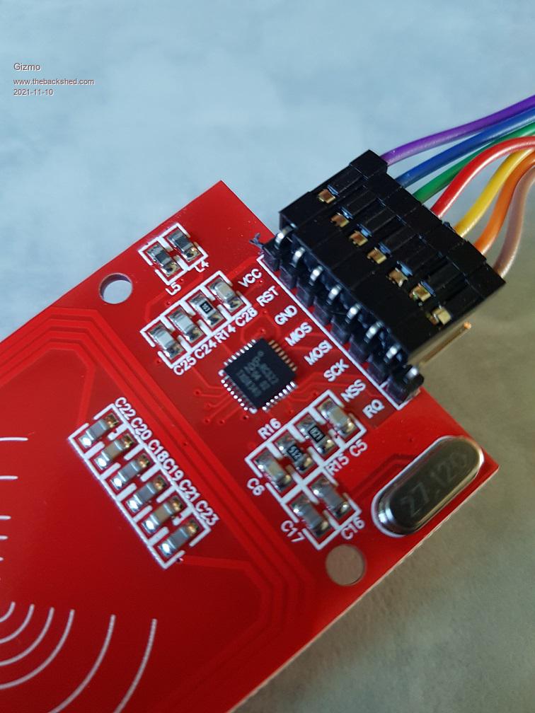

My RFID-RC522 module seams to be a new batch, its labeled differently to every single example I've seen on the internet.
The modules and wiring examples I've seen online have the following pins -
VCC, RST, GND, IRQ, MISO, MOSI, SCL, SDA
Mine is labeled -
VCC, RST, GND, MOS, MOSI, SCK, NSS, IRQ
Which would explain why my tests have all failed.
Edited 2021-11-10 15:20 by Gizmo
Posted: 05:59am 10 Nov 2021
Apart from the pin labeled MOS (Which should be MISO), your board matches the project sheet from Jaycar

No need to poll the I2C or SPI receiver, although, I note that the photo that Gizmo posted DID show an IRQ line which other modules did NOT have - so it was anyone's guess when someone waved a tag or card, but with the IRQ line, you could capture that.
