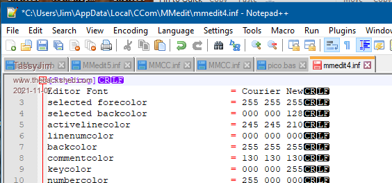

Are we able to change the font in MMEdit yet, Jim?
Posted: 12:57am 07 Nov 2021
Yes.
But you can do that now.
Edit the first line of the mmedit4.inf file
Anything that is not a mono spaced font will not work well.
