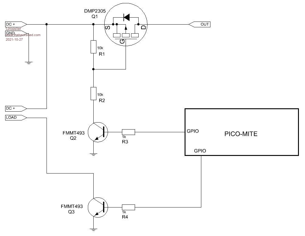

I note that the PicoMite is rather limited with respect to what kind of current it can handle on its I/O pins.  The manual states(page 10) 12mA max, preferably 5mA or so.
Therefore, I was thinking of making a simple and small PCB that would provide BOTH a basic NPN low-side switch, and also a MOSFET high-side driver.
This is the first draft of what I was thinking about.
There would be several identical circuits on the one PCB, with standard 2.54mm pins allowing for easy integration on a PCB or use on a prototyping breadboard.
Q1 would provide a simple ON/OFF MOSFET high-side driver allowing you to switch on and off loads with respect to ground up to 3A @ up to 20v input.  R1 & R2 set the potential on the gate of the MOSFET and this MOSFET cannot exceed a Gs of 8v, so you would be limited to an absolute maximum input supply voltage for the load of 16v.  Generally, 9-13.8v is more common, but you could easily enough change R1 and R2 to allow for higher input voltages if required.
Q2 would provide a simple low-side NPN switch.  This could also be a MOSFET rather then a BiPolar, but as I have both the DMP2305 and FMMT493 in stock in the hundreds...
Q1, Q2 and Q3 are all SOT-23, so very small.
The FMMT493 NPN transistor can switch up to 100v and can pass up to 1A
Ideally, I would prefer an N-Ch MOSFET for Q3, and am having a look around for something, but there are THOUSANDS of MOSFET devices to choose from, so.....does anyone have any suggestions?
Must be SOT-23.
Must be able to pass at least a few amps.
What is the general thoughts of the forum about a module like this for the PICOMITE?
Edited 2021-10-27 16:11 by Grogster

It's specialised and Tinine might love you for it.  :)
Whether there would be a big sale for it I'm not too sure.
I suspect 1A per channel would be more than adequate for most people. Possibly even half that.
If you want to aim at the industrial control market then it has to handle at least 32V (a 24v battery system on trickle charge) as a minimum. It's good to aim for 36V. High side switches tend to predominate too.

I'd welcome any suggestions Tinine might be willing to submit.
I'm not interested in selling this - I would make the PCB files available for free to anyone who wanted to make their own.  I will sell it if there is demand enough, but for the most part, I was just wanting to give a freebee to help the PicoMite with respect to outputs.

For beginners a simple high side driver of 100mA or so (with some sort of overload protection - could be common to all channels if they are all capable of operating it. Resettable fuse?) would be fine. They can hang lots of LEDs and relays on it and the output is logical to the input i.e. pin(1)=1 gives a high output to switch a light on.
Some inputs from potential dividers (or something) would be nice so that they can be connected to 5v safely. You probably don't need 5v outputs for most experimenters. that could be something else - a level shifter board.
