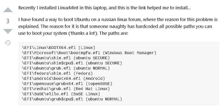

I have found some interesting information on the net.
MANY people have this issue with this series of Acer notebooks, and it would seem to be that these Acer's expect ONLY a select number of predetermined paths to any bootloader in the EFI partition.  Don't use one of the supported paths, and the machine won't boot.
Nice one, Acer....
LINK to above thread quote...
Basically, it would appear that I need to install Mint, then I need to reboot from the live-USB again, and then make a new folder in the EFI partition such as \EFI\ubuntu\ - which is one of the supported paths, and copy all the EFI files from the Linux install EFI folder, to the 'Ubuntu' one before this machine will acknowledge anything and boot.
What cretin would hard-code the install paths in a modern UEFI system?! (rhetorical)
One of the ideas of UEFI, is that you can specify the path to the f-ing bootloader.
Hard-coding only a select number of paths, and then not really telling anyone about that, is like......damn!
So, I will do that change now, and see if the bastard boots Mint then.

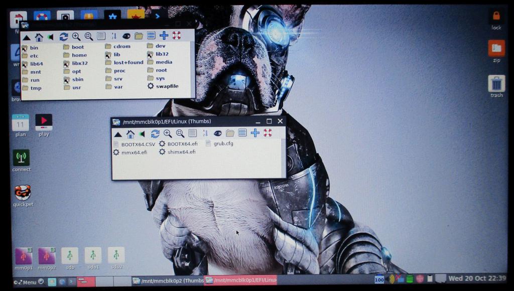

OK, this laptop now boots Linux Mint on the internal EMMC drive.
I used my old faithful Puppy USB to mount the hidden partitions, and created a new folder: EFI\Linux
Copied all the files from "ubuntu" to the Linux folder.
Renamed the GRUBX64.EFI file to BOOTX64.EFI
Rebooted the machine, and away Mint goes.

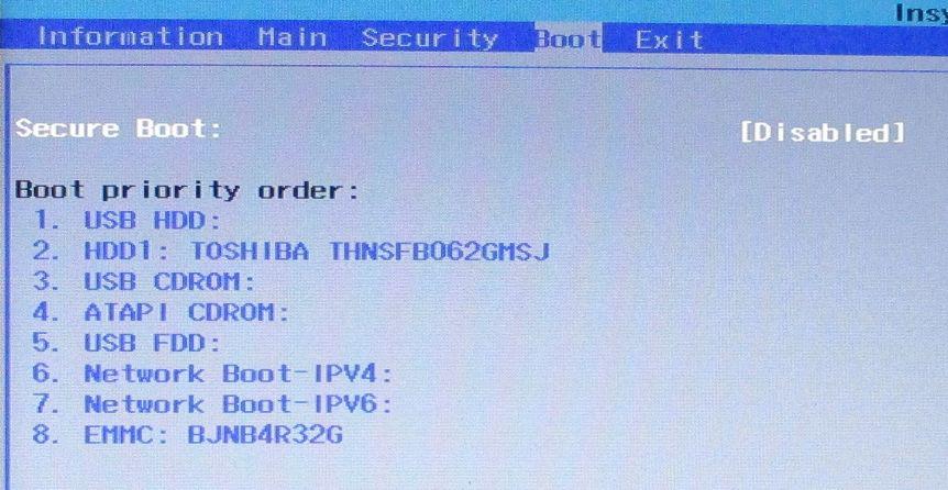

In the BIOS, the boot-order now shows "Linux" as #1.
I have changed that so the machine still tries to boot the USB first, then "Linux" second.
Quite the saga, but a solution has been found, but I pity anyone else who does not really know that much about Linux - perhaps trying out a Linux Mint install - and gets THIS run-around.  They would be blaming Linux Mint when it failed to boot.....
