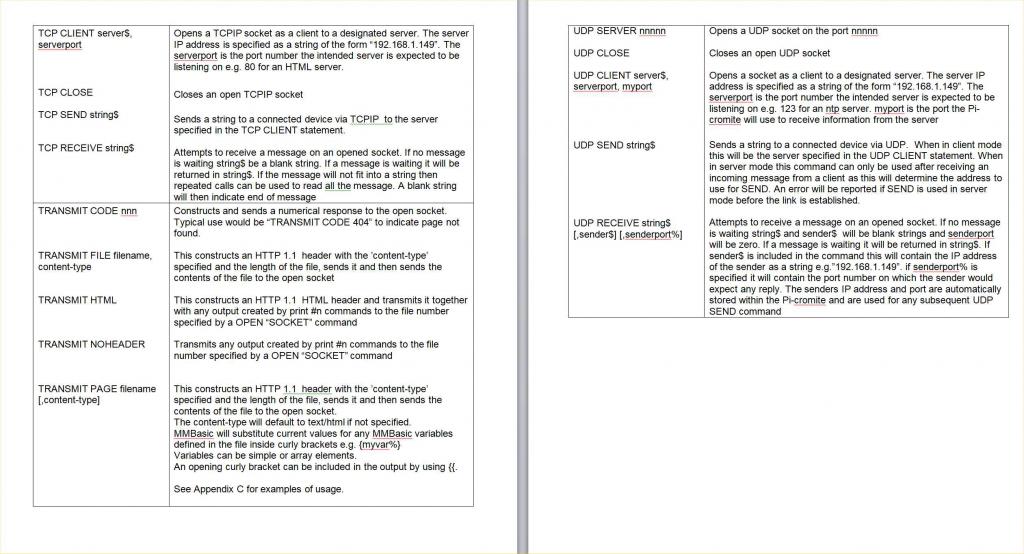

Sounds a really interesting project. On the port I did for the Raspberry Pi (now defunct) I wrote some code that allowed MMbasic variables to automatically populate html and had support for TCP and UDP
Feel free to use/abuse the ideas as you wish. More info in the manual for MMbasic on the PI-Cromite
