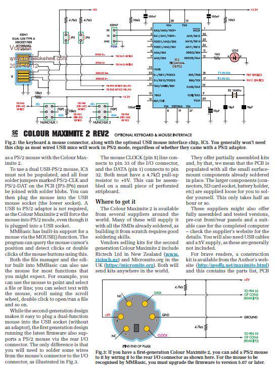

I'm not familiar with the gen 2 version, but don't you blob one pair of jumpers or the other, depending on which type of mouse is being installed? I think I saw something about not blobbing all four of them.
EDIT:
Scratch that. You need to blob all four & install R80 and R81 (4k7) for a PS2 mouse. You've not to install the Hobbytronics chip if the board is set up for a PS2 mouse.
I was going to suggest not configuring the mouse, but setting up those GPIO inputs as ordinary DIN types then manually pulling them down to prove that the hardware was working. Unfortunately I don't know the GPIO pins for the Gen 2, only that they aren't the same as the Gen 1.
