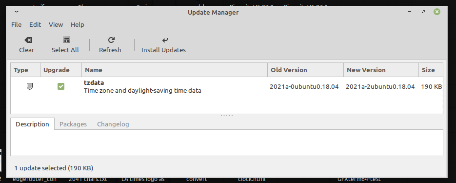

are you updating using the 'Update Manager' (GUI) that is accessed using the small shield icon in the system tray?
with Linux Mint XFCE, versions 19 and 20, the Update Manager only asks me for the password once at the beginning of a series of updates.
for things typed in at a command prompt, linux seems to remember once the password has been typed in for something like the next 30 seconds or so.

That's the one! - Run Update Manager & click "Select All" then "Install Updates".

The Update manager (or package installer) should *not* ask you every time for the sudoer pass - only when you click on "install" should you be asked to enter a password, only once; the rest of the process should use the same provided credential.
Could you explain in a little more detail what you're doing?

Mint is very user friendly. IIRC you just click on the little shield icon at the bottom right of the desktop to start the update manager. I seem to remember that its colour changes depending on whether or not updates are waiting.
