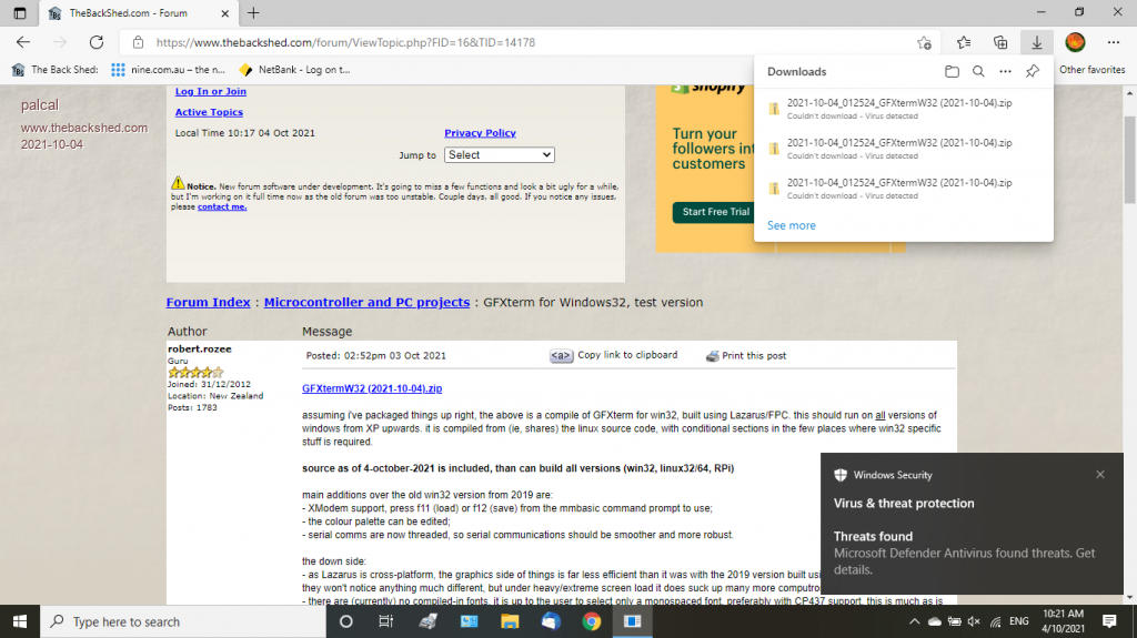

I downloaded on my laptop, no problems but on the box in my workshop running maybe a later version of Win10, it won't download because it has a virus.

That might be a false positive caused by a short piece of the code being wrongly recognised. If the two machines are using different virus checkers then that would explain it.
Posted: 09:43pm 03 Oct 2021
a false positive i'm afraid. the .exe file is compressed with UPX, which anti-virus software absolutely hates. i vaguely remember there was a workaround, but can't remember the details. can anyone else comment on the solution?

I came back to the laptop to transfer the file to a USB stick and then to my workshop box, but it has now been removed fom the laptop
Virus. Win32/Sabsik.TE.A!ml

I don't have any antivirus just windows defender, I could turn off "Virus and threat protection' if there is obviously no virus.
Funny that 3 different machines with only Defender all say there is a virus.
I have also deleted the download and re downloaded twice to no avail.
Edited 2021-10-04 09:33 by palcal

Using Chrome, I ran Windows Update and updated not that that should make a difference but I downloaded again and whilst I did get a warning I clicked 'Run Anyway' and all is OK. I will now try on the laptop.
