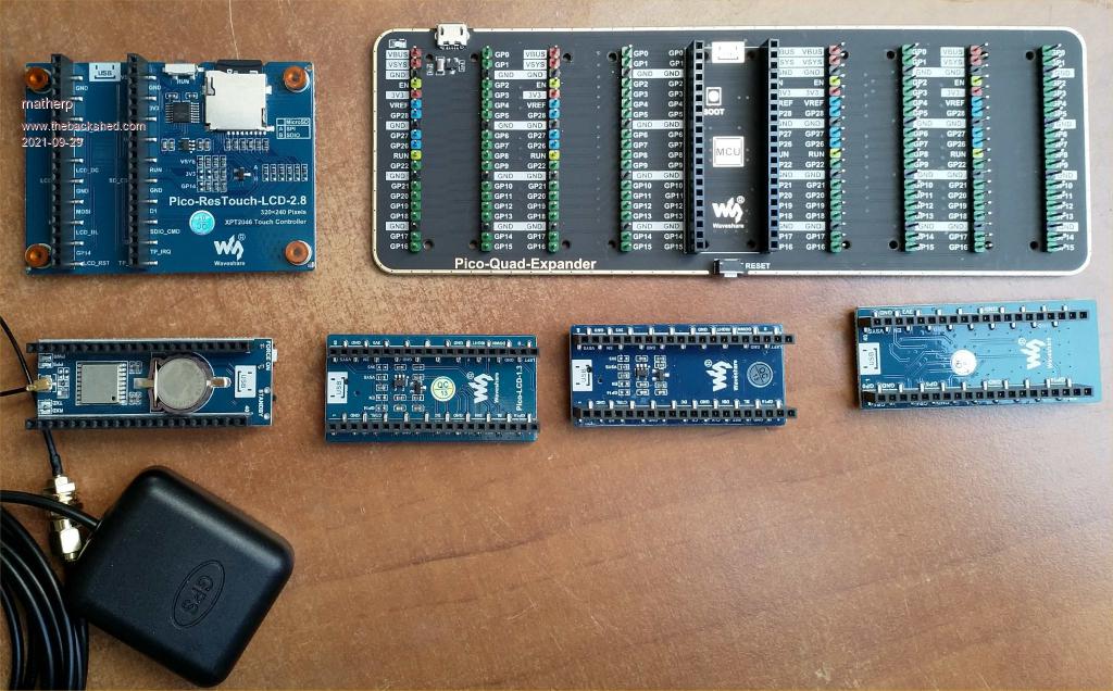

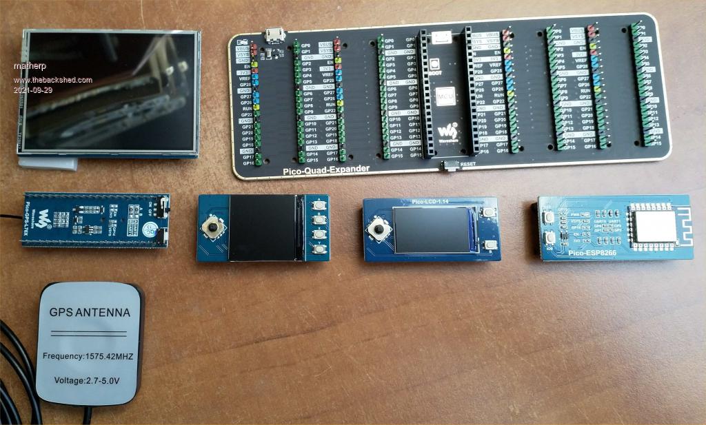

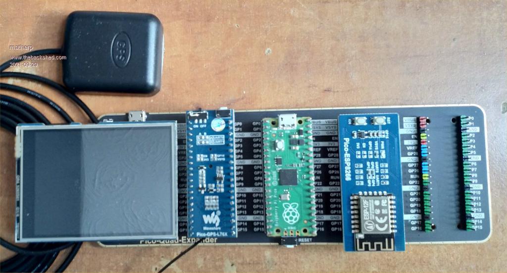

Waveshare do some really nice Pico compatible modules. I've just bought a selection. Total cost to me including shipping GBP60.60, time to arrive from order just 8 days.
The quality of Waveshare stuff seems very good.
Included are a quad motherboard that allows multiple modules to link to the Pico. Without this many of them can also be stacked. Waveshare also do a couple of 2 way expanders.
Also included are a Pico compatible mounted ESP8266, a Pico compatible mounted GPS, a 240x135 display with two buttons and a joystick, a 240x240 display with 4 buttons and a joystick and a 320x240 touch display with SDcard slot.
All the displays use the ST7789 driver so I'll modify the firmware to support all three variants and post both the firmware and configuration details when available.
By default the GPS and ESP8266 communicate on COM1 (GP0, GP1) but both can be modified to support COM2 (GP4, GP5).
These sorts of modules together with MMBasic make it very easy to build embedded devices with graphics, I/O, SDcard etc. with no soldering or H/W design needed

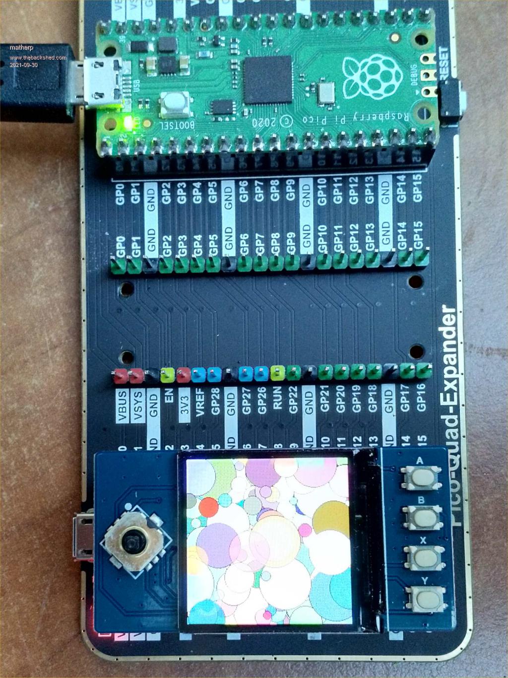

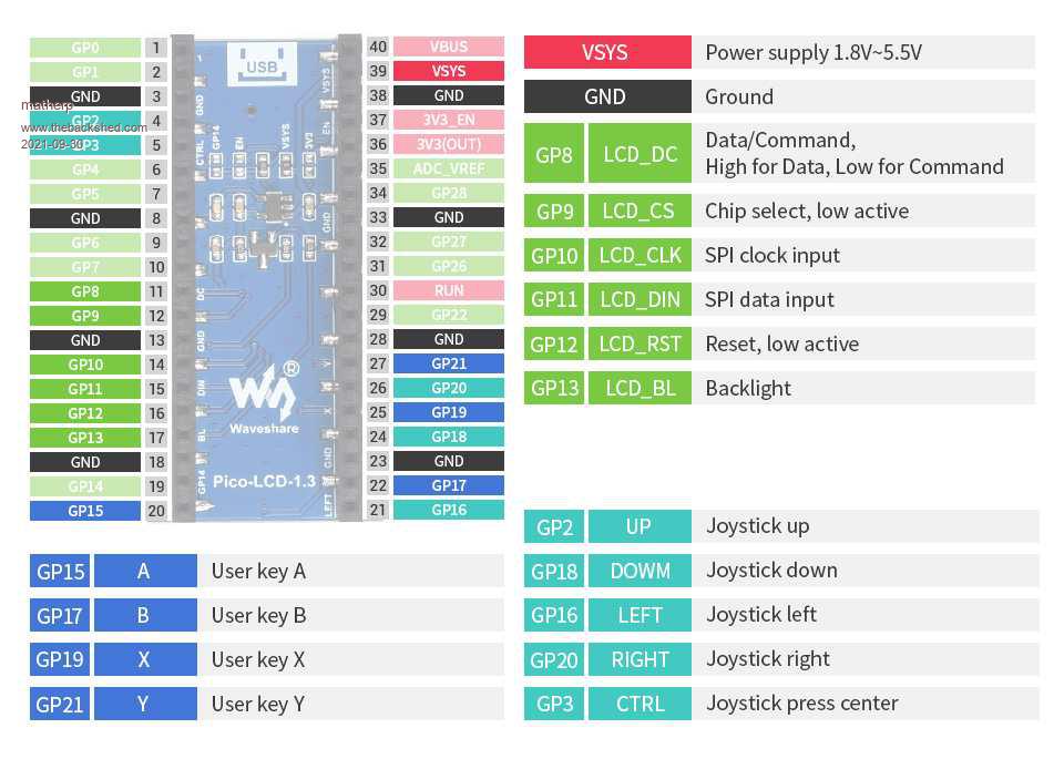

Here is the first display working. This is the 240x240 ST7789 which is already fully supported by the firmware. The display is small but very colourful and bright
OPTION SYSTEM SPI GP10,GP11,GP28
OPTION LCDPANEL ST7789, LANDSCAPE,GP8,GP12,GP9
The display doesn't use SPI2 MISO but we need to allocate it so I've used GP28 which isn't used by anything else on the board
Other pins are:
Note: firmware versions below b22 will show landscape and reverse landscape reversed when using option list. Setting landscape matches the text on the buttons.
If you want to control the brightness of the display use
setpin gp13,pwm6b
pwm 6,1000,,requiredbrightness

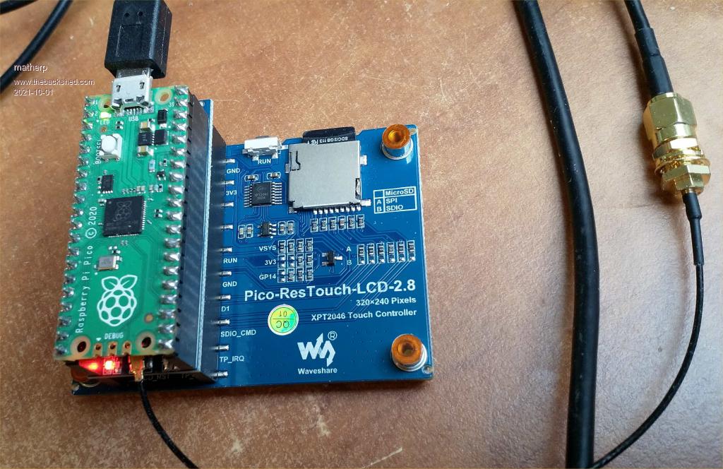

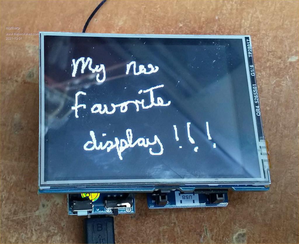

The 2.8" ST7789 display from Waveshare is my new favourite display. The image is very clear and bright with a very wide viewing angle (IPS).
BLIT and transparent text work perfectly (b23 onwards) and the way the Pico mounts to the back makes it very easy to use. Additional Pico boards can also be stacked. In the picture the Pico is mounted to a GPS and then the display, everything that is needed for a Geoff Graham SuperClock.
Configuration for the display is as follows:
OPTION SDCARD GP22
OPTION SYSTEM SPI GP10,GP11,GP12
OPTION LCDPANEL ST7789_320, LANDSCAPE,GP8,GP15,GP9,GP13
OPTION TOUCH GP16,GP17
GUI CALIBRATE 0, 408, 3901, 900, -646
and the SDcard and touch also work perfectly
