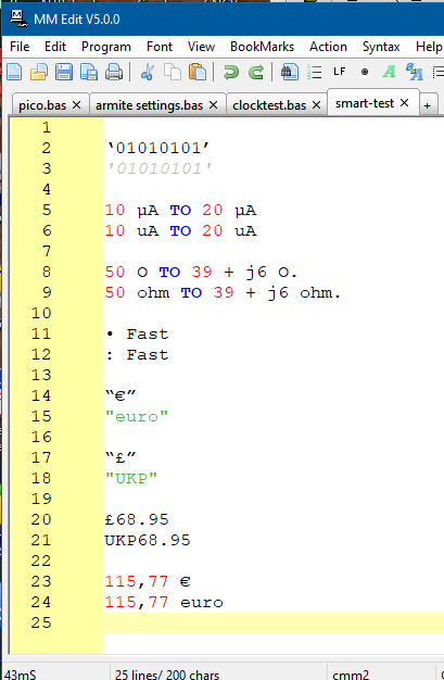

MMBasic requires true ASCII in the code. No extended ASCII allowed as it would conflict with command tokens.
The current version of MMEdit has a function to check for and replace some of the most common problems such as curly or 'smart' quotes.
The new version of MMEdit is compiled as Unicode so I have to do things differently.
If I let the system convert files to ASCII, they end up with far too many ? characters. I have put a function in to convert to ASCII, making a a few obvious changes to suit MMBasic.
I have also included some characters that appear in datasheets etc and cause grief when posting extracts to this forum.
In the image below, the first line is a paste from an external source followed by a "paste in ASCII"
Note the ohm character not correctly shown in the ohm example.
By using "paste in ASCII", the converted text is put back into the clipboard as well as the open file so it can be used to sanitise any text ready for posting here.
Not shown is +/- and a few dash and space characters.
The question is what characters have I missed?

Hi TassyJim,
I am not sure how unicode affects things, but I would definitely like to see the "degrees" symbol (degrees C, degrees F). But maybe that is already in standard ASCII ?
Thanks,
Posts: 6607
Posted: 10:48am 16 Sep 2021
  Volhout said  Hi TassyJim,
Thanks,
Most if not all MMBasic fonts have the degree symbol replacing the back tick ` so it is well catered for. It is one substitution I have already put in the mix.
