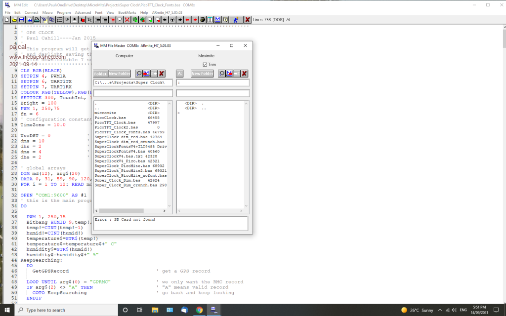

I am having all sorts of problems connecting the PICOMITE to MMEdit. On my desktop it won't connect at all, on my laptop it works to download files to The Pico but I can't upload from the Pico to the PC.
It's probably something simple, it did work on the desktop box then stopped so I downloaded the latest version but still no go. It connects as far as the serial connection is concerned but I cant use File Master to transfer files.

Downloaded and installed the file but no change. I am obviously doing something wrong. In the file transfer pop up on the right hand side at first it says "working" and then "dir." and "dir.." how can I select the file?

I saw this if SD Card is not in when you open the FileManager browse window.  Press the A: button to make it try and read again. You do have the Error: SDCard not found, which it gives if SDCard is not in. Can the PicoMite use the SDCard OK ie.

If I type "Files" I get "error SD Card not found" as expected. I have never needed an sd card with the MM is this different. Do I have to save to an SD card first.
