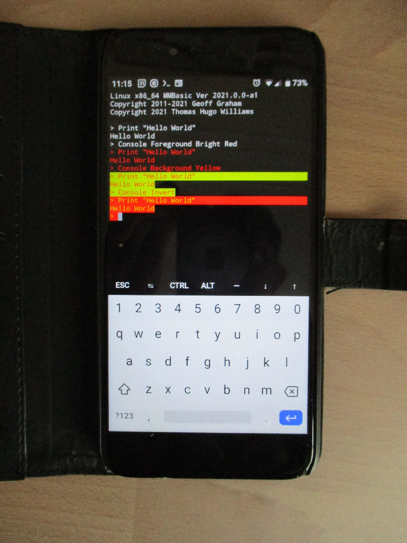

MMBasic is running natively on the phone (I'm not cheating by logging into a Linux box). Terminal emulation is provided by the Termux app.
Whilst I can run commands at the command line it won't list or run programs "in flash" at the moment. I don't expect it will be difficult to flush out the issue when I come back to it ... perhaps some bad pointer cast somewhere.

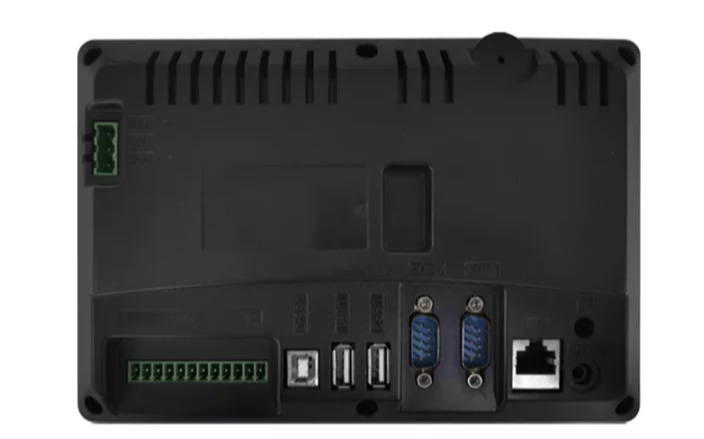

All these backpacks that are designed around PIC and STM32 chips running MMBasic are basically targetting this product. USB (keyb+mouse and terminal), serial (2x), ethernet, and discrete IO. Most likely 24V in / relay out. This is just perfect.
