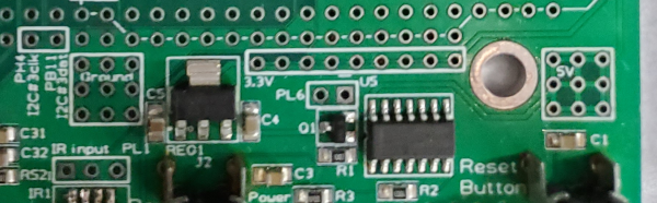

CircuitGizmos
Joined: 08/09/2011
Posts: 1427
Posted: 03:10pm 30 Aug 2021
Below the sea-of-holes on the RetroMax are unpopulated connections to Gnd, 5V, and 3.3V.
