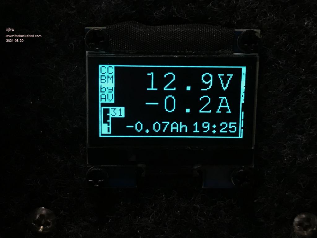

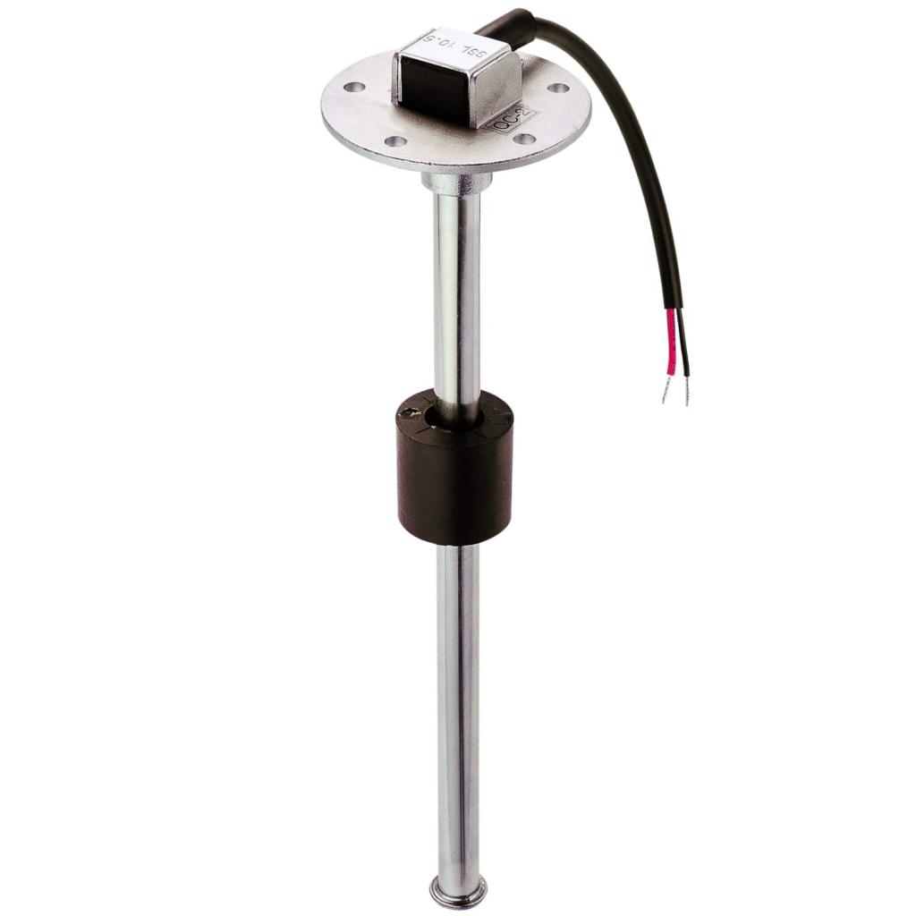

How deep is the tank?  In my camper trailer which has a 90L tank that is 600mm high I went with one of these from KUS (see below).  Available from most boat shops.  I looked at some ultrasonic sensors but discovered some obstacles, well in my application anyway.
These senders are 240-33ohm with 21 steps and so gives about a 3L resolution, was easy to interface with a analogue pin on the MuP Mite.  Thanks Mick.  There is a pic below with the OLED screen I used.  The tank level is bottom left.
Anthony.
Image belongs too
https://kus-usa.com/products/liquid-level-sender/

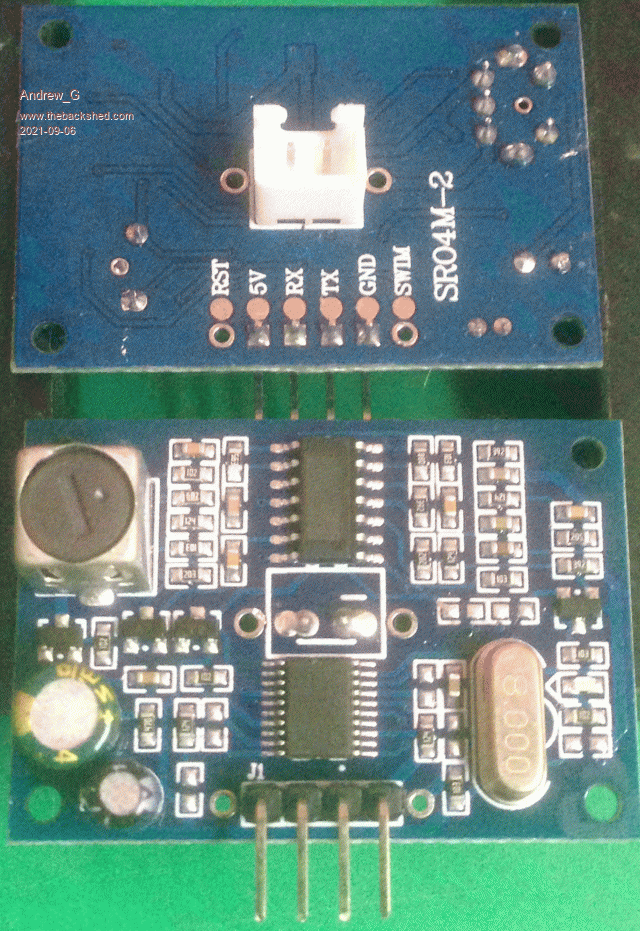

My SR04M-2 sensors arrived:
1) What are the 'RST' and 'SWIM' either side of the four main pins (J1) (I couldn't get the RST to reset - how should it work?).
I knocked up the following code (based on BigMik's)
dim integer TrigPin=15
dim integer EchoPin=16
Dim Float Depth
 Depth = DISTANCE(TrigPin, EchoPin)
 Print Depth
 pause 2000
Loop While Inkey$ = ""
I'm using MMBasic 5.05.04 on a MM170. I've left the two pads just left of J1 disconnected - is that correct?
With the Trigger and Echo pins connected as above the LED on the unit flashes when the MM sends a trigger but the response is '-2' (the not connected or fault message).
BUT if I disconnect Trigger I get accurate distance measurements every 2000ms and the LED flashes quickly continuously.
2) What is happening?
Cheers, Andrew
Edited 2021-09-06 10:26 by Andrew_G
Posted: 12:27am 06 Sep 2021
Have you got a link to the module you purchased?
It looks different to mine.

I use SR04 which just has trig and echo. The one you have seems to have a few modes. See here for details of a similar one. Looks like you need to set it mode via a resistor.
Gerry
F4 H7FotSF4xGT
Posted: 12:33am 06 Sep 2021
This link might help:
https://bitbucket.org/teckel12/arduino-new-ping/issues/40/aj-sr04m-board
https://tutorials.probots.co.in/communicating-with-a-waterproof-ultrasonic-sensor-aj-sr04m-jsn-sr04t/

This  is the module I bought - it differs from what arrived (which have the RST and SWIM) and whatever else.
On one site I looked at they spoke about the newer modules needing a longer trigger to work properly - could this be an issue?
Is there a way of doing it without the DISTANCE command?
Cheers,
Andrew
Posted: 12:47am 06 Sep 2021
You should be able to get it into serial mode which looks interesting.
see the second link I added to my previous post.
Edited 2021-09-06 10:48 by TassyJim
Andrew_G
Joined: 18/10/2016
Posts: 917
Posted: 01:01am 06 Sep 2021
Gerry,
Thanks and yes there is a temptation to try the other modes but they seem to have a different mode of operation which may not work with Peter's CFUNCTION?
and Jim,
Thanks too, the article you link to is one of the ones talking about a longer trigger time - but the other respondents seem to dismiss it?
Is it easy to change Peter's CFUNCTION to change the time?
Andrew
Edit: Thanks Jim I'd missed your additional link.
Edited 2021-09-06 11:14 by Andrew_G
