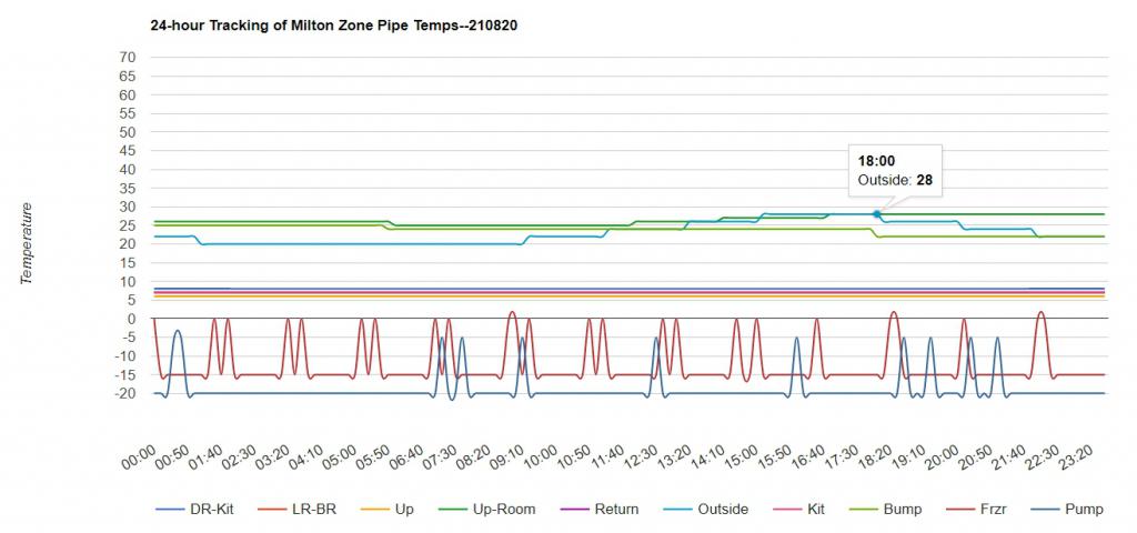

I monitored the Tasmota POWR2 web page on my phone while washing the dishes. The pump came on, and after peaking at 1099 watts, it settled around 1033 watts for the remainder of its 63-second run time.
Why might a nominal 1/2 HP motor, which again nominally would seem to have an FLC of 746/2 or 373 watts actually run at 1033 watts (assuming that Tasmota on the POWR2 is accurately reporting the power)?

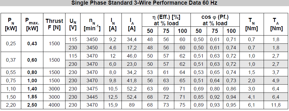

That's a huge difference for a pump after a minute. Even a really bad power factor shouldn't do that. A 15A breaker should have tripped. I'd be tempted to check the motor current with an ammeter as I'm not convinced that the reading is anywhere near accurate.
Posted: 02:29pm 19 Aug 2021
Mick--thanks for the response. I've never tested current on an AC 110V line except with a Kill A Watt plug-in (can I count on that to be well-calibrated?), and in the recesses of my unfinished basement, it won't be easy for me to turn the water on so I can be watching when the pump comes on.
I guess I can set up outside with a Kill A Watt, a 2nd POWR2 and a submersible river water pump cycling in a bucket to see how the Kill A Watt reading compares to the POWR2.
FWIW, the 1033 watts reading if divided by the 60 for the about one minute run time gives 17 watts, which is at least in the ball park with the 14 watts which the telemetry reports.

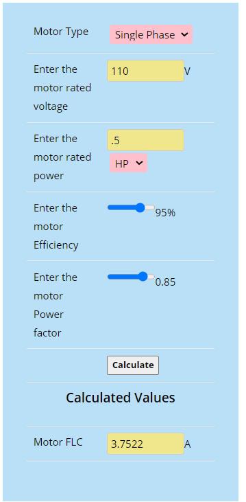

Posted: 02:39pm 19 Aug 2021
  Mixtel90 said  0.5hp = 370W = 7.9A FLC at 110V
Why does this FLC calculator say that a single-phase 110V .5hp motor should have an FLC of 3.7522A?

Posted: 03:28pm 19 Aug 2021
  Mixtel90 said  Firstly, your device is reporting kWh then, not kW. :)
I think that's what I was saying some posts ago (if we're talking about the same thing). The GUI site "Power" line in watts is the rate which, if maintained over the course of an hour, would use that many watt-hours. In fact, divided by the approximately 1-minute run time (1033/60=17.2) gives about the watt-hours used which is reported by the telemetry, 14-watt-hours.
  Mixtel90 said  That calculator looks wrong. I think it's actually using a 240v setting no matter what you specify. :)

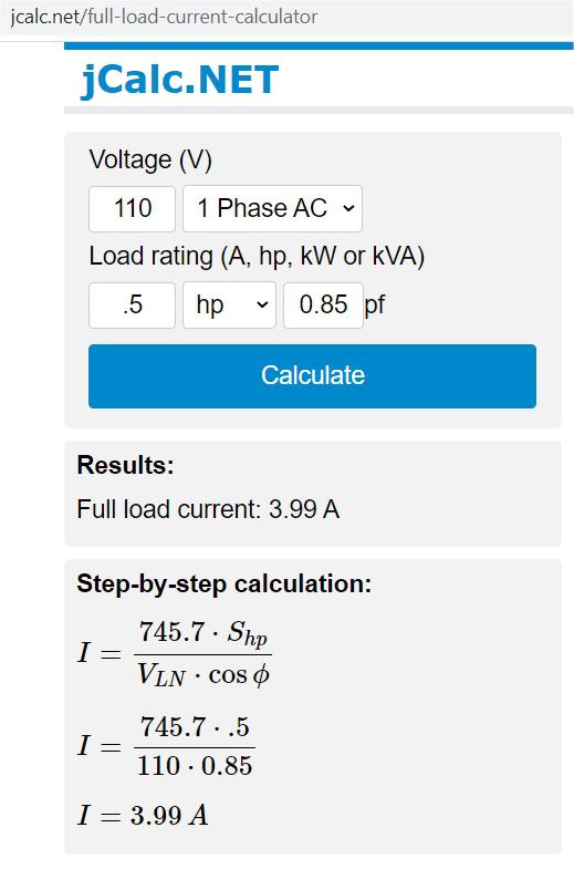

Here's another FLC calculator which gives (nearly) the same results as the other one, including the formula it used to make the calculation. Is there something wrong with that formula, or why does the result differ so significantly from the charts you link to?

  Mixtel90 said  I've no idea. :)
Frustrating that the calculators and charts differ from each other by about a factor of 2.
