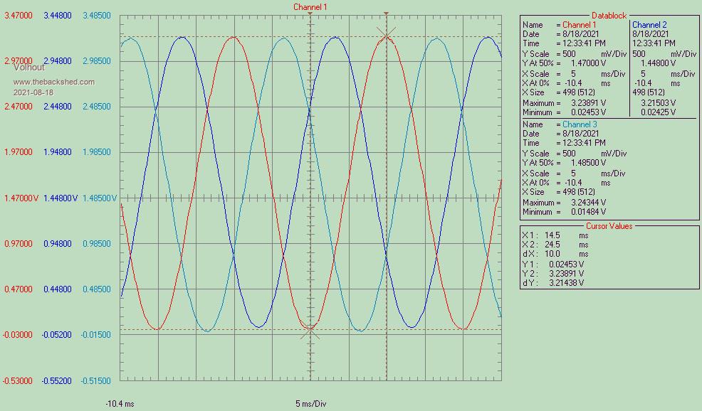

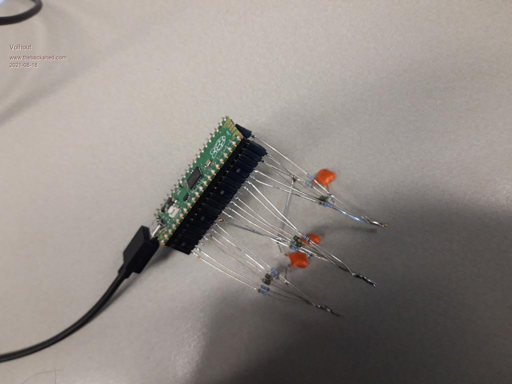

The test circuit:
The output signals measured with a 4 channel oscilloscope.

I like that. It's got bits hanging in mid air, just as they should. :)

The jitter is less than 1us.
// 3 phase generator
// This is a 50Hz 3 phase (L1/L2/L3) generator running on ATMEGA328
// Outputs are 3x 6 bit ports, that need an external DAC (resistor network).
// In prototype setup 36k, 18k, 9.1k, (2.7+1.8)k, 2.2k, 1.1k where used with 1uF filter cap.
// Each sine wave consists of 128 samples.
// Uses a Timer 1 polled for most accurate timing.
const int samples = 128;   // samples per sine
