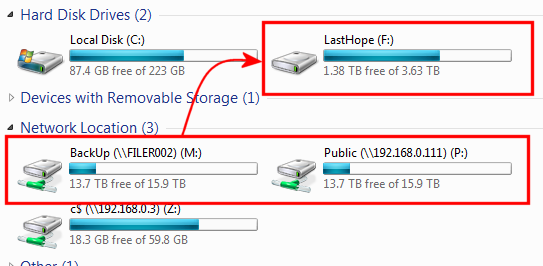

so here are the two NAS disks (the drobo reports the whole array for both disks - a quirk) and the single USB3 disk that as you can see is appropriately named "Last Hope"

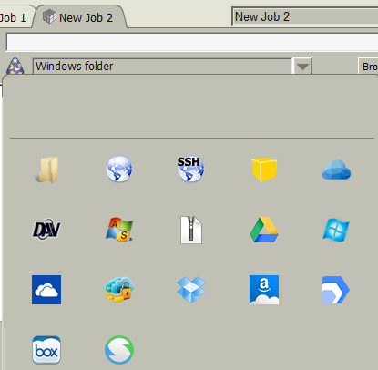

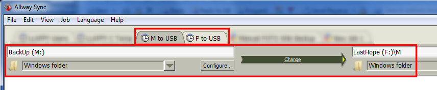

then using Allway Sync (excellent backup software) with the two backup jobs to simply replicate the entire structures (i.e. new/modify/delete are propagated) to two folders on last hope

Of course none of this matters if the office burns down - I do have a Google Drive where I backup *REALLY* important stuff manually. Allway sync does have options for various cloud storage packages as well.
