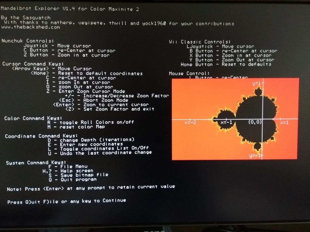

I don't supposed there is anyone running 5.07.00 who has a copy of "The Welcome Tape 1.0.0" and could run up the "Mandelbrot Explorer" program and post a screen-shot (or even blury photo) of the Intro/Help page ? My CMM2's are all now running the RC1 firmware and I'm strapped for time and could do without having to wind one of them back.

Hi Tom,
Blurry photo?  Challenge accepted.  Hope this helps...
Thanks for your continuing efforts with the Welcome Tape and CMM2 generally
- Tim
Posts: 4410
Posted: 04:04pm 16 Aug 2021
Thank you Tim, that confirms my suspicion that the image hiding the Mouse Control instructions was a pre-existing issue and not new for 5.07.01. I guess I should add it to my bug list.
