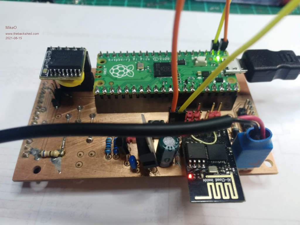

MQTT test using my new, cnc milled, Picomite pcb.
Esp01 loaded with Annex running a mqtt test (using my RPI mqtt broker)
Simple serial receive on the Picomite.

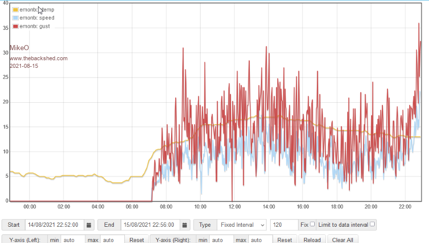

I use a lot of them to monitor sensors for weather , temperatures solar power etc. Mostly I use them flashed with ESPeasy which is extreamly reliable I then send the data via UDP packets. Annex has become quite mature now and especially using an ESP32 instead of the 8266 version would give some enhanced features due to far greater speed and ram memory available , larger json downloads come to mind , processed in the ESP and the required fields just sent to mmbasic . MQTT is another area where the ESP can send data derived picomite for example to a broker on your network (eg rasp pi) for storage and visualisation.
Like this (wild winds here tonight)
