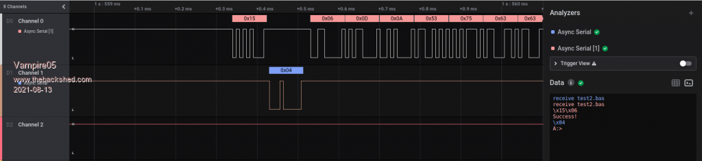

Posted: 05:56pm 12 Aug 2021
Ok i had no luck.
i hooked up my new 9 Euro Logic analyzer  and recorded some strange behaviour i can not explain:
Channel 0 is the receiver (Arduino) and Channel 1 is the CMM2.
The code is:
print #1, "receive " + args(2)
xmodem send args(2), 1
The Receiver sends correctly a <NAK>. Why the CMM2 responds with an <EOT> ????
Vampire05
Joined: 06/12/2020
Posts: 88
Posted: 06:06pm 12 Aug 2021
Ok got it!
test2.bas is an empty file. i am sitting here some houers an try to send an empty file
